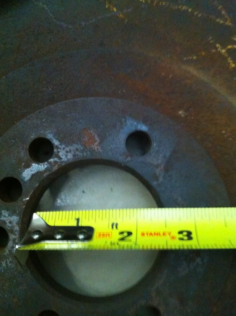

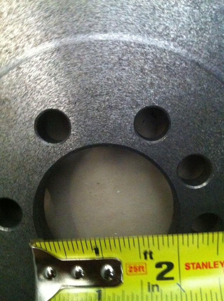

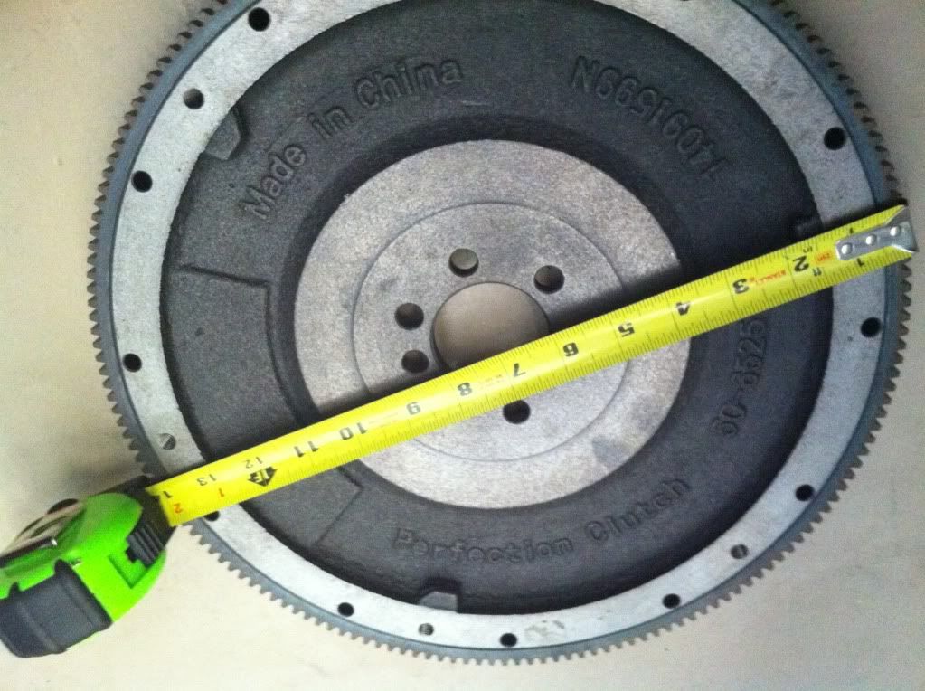

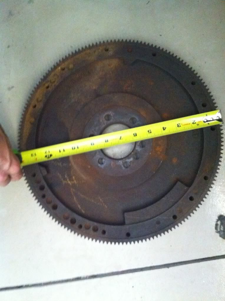

Ok Here are the flywheels and the coupler I got off the boat.
I measured them both and both of the flywheels are 14". You can see how the bolt pattern is way different though.
The old flywheel would not fit the new engine but the new flywheel fit the new engine but now the coupler wont fit the new flywheel so I need to get a new coupler.

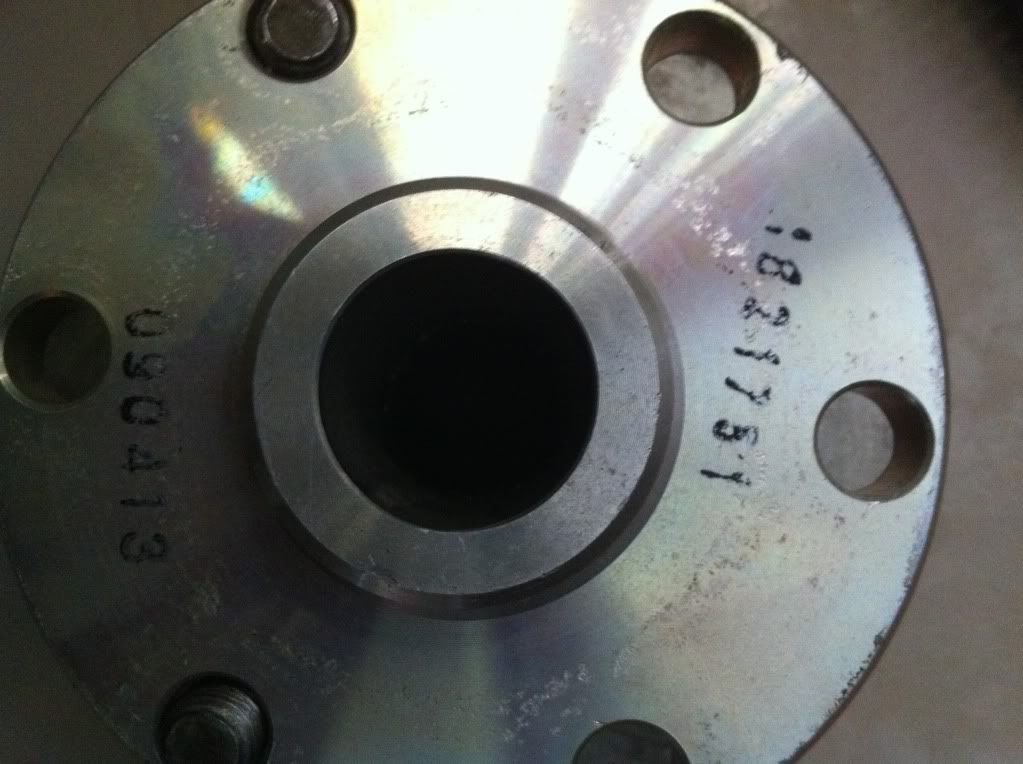

Re: New engine flywheel from old doesnt fit coupler?
The new one in the pics is the one that fits the new engine crank.
the old rusted one in the pics is the one I took off of the old engine that fits the coupler.
The coupler does not fit the new flywheel which fits the new engine.
Sucks too because it looks brand new (coupler).
So basically I need to make sure I get the right coupler that fits the new flywheel.
I assume the new one is the smaller bolt pattern since the center hole is smaller.
