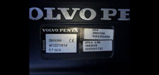

Been working on an engine replacement (long block 5.7).
We (think) we have everything back in place - new engine; outdrive mounted; new bellows etc. etc.
We have no fire - hooked up a spark plug diagnostic tool - no lights flashing on when cranking.
Reset the distributor several different ways - hooked up a known hood coil (the old one looked fine). Checked the kill switch, checked the starter wires.
Totally at a loss here.
BTW...the long block engine is a mercruiser block with all the original Volvo accessories taken off the old engine. All accessories (starter, bell housing, intake manifold etc. etc.) bolted back on in place with no issues.

alldodge
Mar 8, 2009
44,443
Serial number comes back as Gi-G
Fuel pressure low side 8 psi +/- 4 , high side 50 to 60 psi
