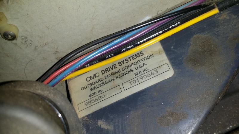

Thanks, I just figured that out after poking around the forums and the stickies. where can i find the model number? So when i go to order parts i know what to get
bruceb58
Mar 5, 2006
30,804
Well, it originally was on a sticker on the thermostat housing.
BTW, you should read this site:
http://www.hastings.org/~stuart/cobra/

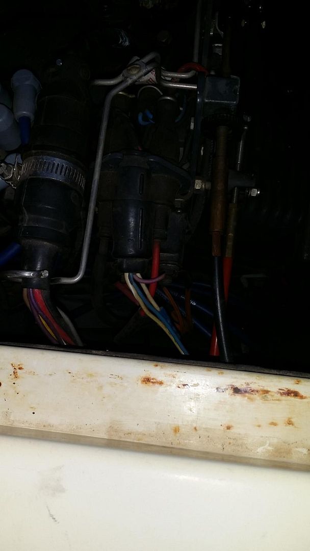

if I do the exhaust out the transom it will be pretty low. that's the only open spot there really is. the power steering rack is in the way on 1 side. I will take pics and post them to get your guys feed back.

numbers on the transom mount
whats the cut purple wire?
the back, the power steering is about there the rear swim platform is on the drivers side of the boat
