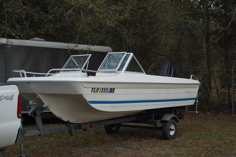

I am new here and I just wanted to say hello and tell you about me and my sons new project boat.
I just picked up a 1971 rinker built 17ft trihull, it came with trailer and 65hp mercury. Got it for a steal. The trailer is in pretty gvood shape, motor runs, and the boat is in fair shape.

Welcome to Iboats. Not a bad looking boat. Obviously it need interior work. What plans do you have for it? Have you checked for weak spots in the transom, and deck? Does the hull have any kind of stress cracks? Stress cracks in the transom? Any known leaks? I see the keel looks like it's been patched in the past.
A basic test for checking transom rot would be to bump it and listen to the sound, and watch the give the glass has when you bump it. You can also also check the deck for rot by sound when bumping or tapping on it, but also on how much give it has in the floor when stepping around on it. The deck can also have some give when the stringers beneath are rotting out.
If you happen to undo a screw in the transom and water drips out that can also be a sign of rot.
Not sure on if that boat had foam floatation in it or not, but that could also be checked for saturation by taking a core sample of the foam.

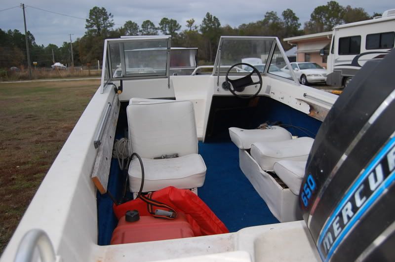

Here is what I know of the boat so far. I dont see any stress cracks on the glass that I can see. The floor has a little soft spot right behind the driver seats. The transom has been redone from the inside, and the transome is solid as a rock. As far as the foam goes I havent checked it out yet,dont realy know how to. Have not had a chance to take the boat out yet been super busy at work.

to check the foam, get a hole saw, that you use in a drill. 1 1/2 inch. drill a hole in several spots, saving the plugs. now take a piece of 3/4 or 1 inch pvc, cut some knotches in the end, like teeth. twist this down into the foam. push the core out, you will know immediately if the foam is wet. if all is good, get a tube of 3M- 5200, and reinstall the plugs.

I drilled to hole on either side of the front . the foam seems very hard not spongy. How do I know if the foam is bad

wet = bad

as said it the core comes out wet, it is bad. it hold water, it has been known to take 700 lbs, of wet foam out of a boat that size. the wet foam also causes the stringer (frame/backbone) to rot. if your is dry, just cut out the soft spot and patch it.
