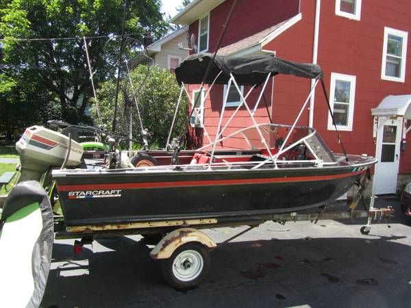

See if this works...
dozerII
Oct 25, 2009
6,527
Re: New member and Starcraft owner
First off welcome MN, the Starmada has a real fine group of guys. Second that is a very nice looking Nova!! I'm thinking your going to get lots of flack for turning that into a duck hunting boat!!

Oh man, you stole it...don't let the clearance-rack price-tag fool you...Real gem right there!
Novas love black with a blood-red stripe in that recess above the numbers...others are beige with black in the recess.
attachment.php
^^^I'm willing to be that she's black based on the underside!
