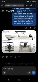

Hi all,
Everyone helped me a lot when I built my floor into this 18ft panga. Now need some opinions on raising the freeboard. I would like to increase freeboard height and create a splashwell at the stern, but keep it very light to avoid any weight up high. See photos attached.
My plan: screw plastic/wax coated plywood to make a form/mold all around the gunwale height of 8 to 12 inches, 4 inch thick, pour 4lb foam.
Remove form, and layup 2 layers of 1708 to tab in and cover the foam. See the Ai schematic for an idea of what I'm going for.
What do you think? Will this be too much weight. I'm thinking it will be no more than 100 lbs total around the whole boat. Just want some more height when it's rough.
