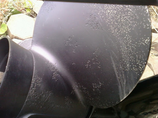

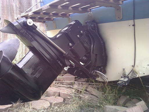

I would like for you to take me about 8 pictures of the bottom of the boat and the transom and a couple of the prop, so I can see if I see anything unusual.

I really do appreciate all the help! Here are some pics I just took. There is some stuff on the hull, about 80% wipes off with just a finger. I'm not even sure what it is, but it's feels like fine sand once it's on your fingers.

and a couple more:

Lee, from looking at the prop pictures it appears to me that you have a major cavitation problem with that prop, and in my opinion, that is where at least one of the problems is with your prop slip.
I want to think about this some more today, and study all of the pictures again, to be sure I don't miss anything with the boat as well.
You did an excellent job with the pictures, I just wanted to let you know.

I agree ^^^^^^ and for those following this thread, those pits in the prop are from Cavitation which is literally a boiling of the water surrounding the propeller due to pressure drop and then a subsequent collapsing of the bubbles that eventually knocks little holes in the prop. It is actually somewhat rare and is usually confused with Ventilation which is the prop grabbing air, either from the surface or due to some turbulence in the vicinity of the prop. This is why the plate above your propeller on I/Os and OBs is actually called an Anti-Ventilation (AV) plate, and not an Anti-Cavitation plate as it is often referred to.
It is harder doing this long distance, than actually being there, but your pictures sure help a lot.
I can't tell how large those particles on the bottom of the boat are, but in theory, if they are large enough and they are really stuck to the bottom of the boat instead of just laying there, then they could be disrupting the clean water flow to the prop and creating the cavitation you are having.
I would appreciate it if you would take a washcloth and try to clean those particles off, and tell me how hard they are to get off. Also, if you would just look back at the last 5' of bottom before the transom and just tell me how much of those particles are there, that will answer my questions.
I find it very unusual that an elephant ear prop, of that size on your boat, has cavitation burns all over it.
There is a possibility that the particles are causing it OR it could be that the prop shop just ruined the prop when they tried to redo it for the previous owner, but if those particles don't come off easily that will help us make a better decision of which way to go.
