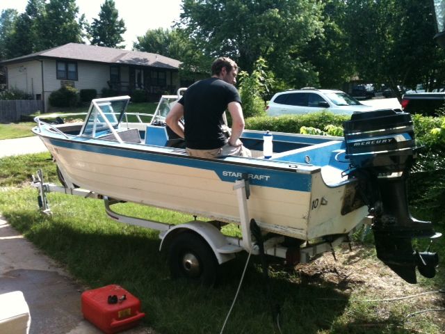

Hello,

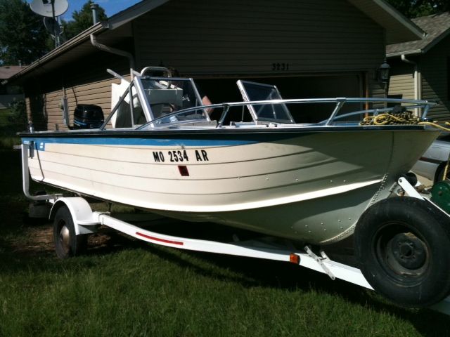

recently got rid of my old '69 Speedliner glass boat and picked up a '77 (or '76) StarCraft 16' Super Sport. Decided on a StarCraft right away as we were wanting an aluminum runabout style boat with an outboard, on a budget. Looked at a few and really liked the open bow and 85hp this boat offered. Got the asking price down from $2k to $1300 and trailered her home.

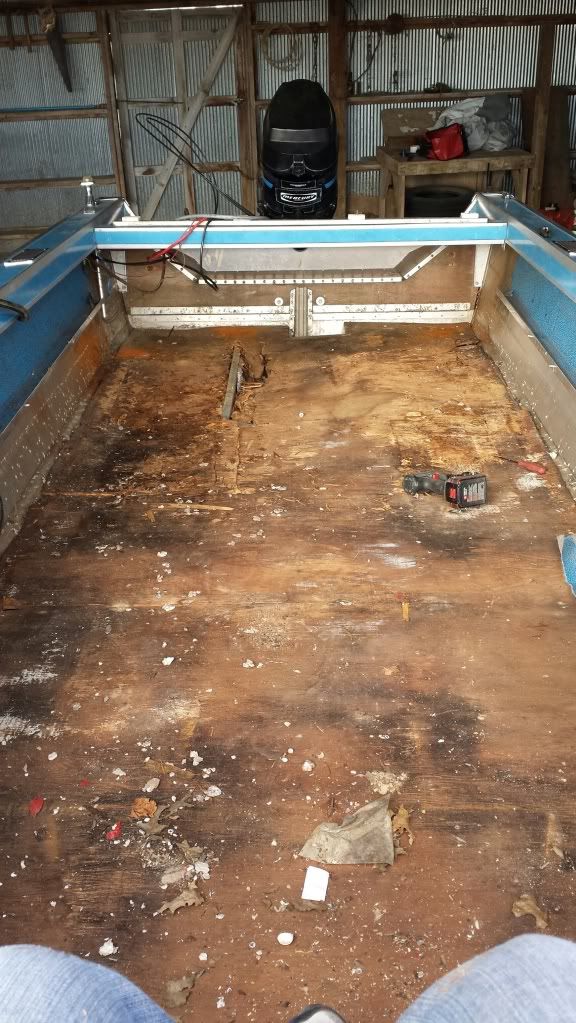

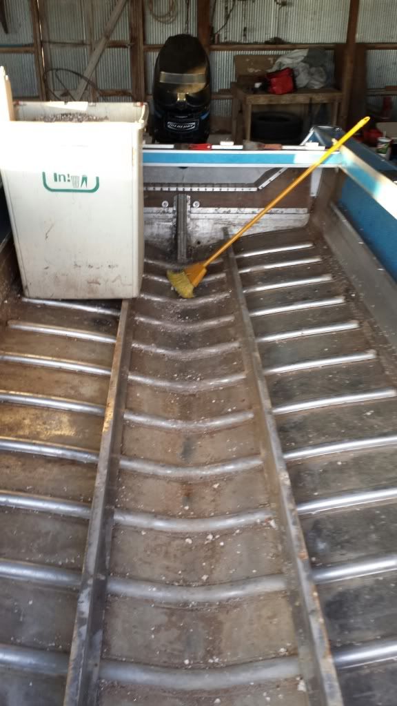

Had what looked like 3 new tires tread wise, but lost a big strip of tread on one today so too many years of sitting. Spent the day cleaning. Got the Merc to start and run. Ordered a water pump kit, fuel pump kit, bilge pump & switch, Merc manual, and some other stuff. Still have some wiring to redo, but looking forward to getting it in the water soon.

Re: New Starcraft Owner
nice boat, welcome, don't hesitate to ask Qs. that one pic of person sitting on gunwale really brings home how much smaller the 16' hull is than the 18....should be really manageable

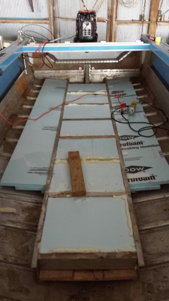

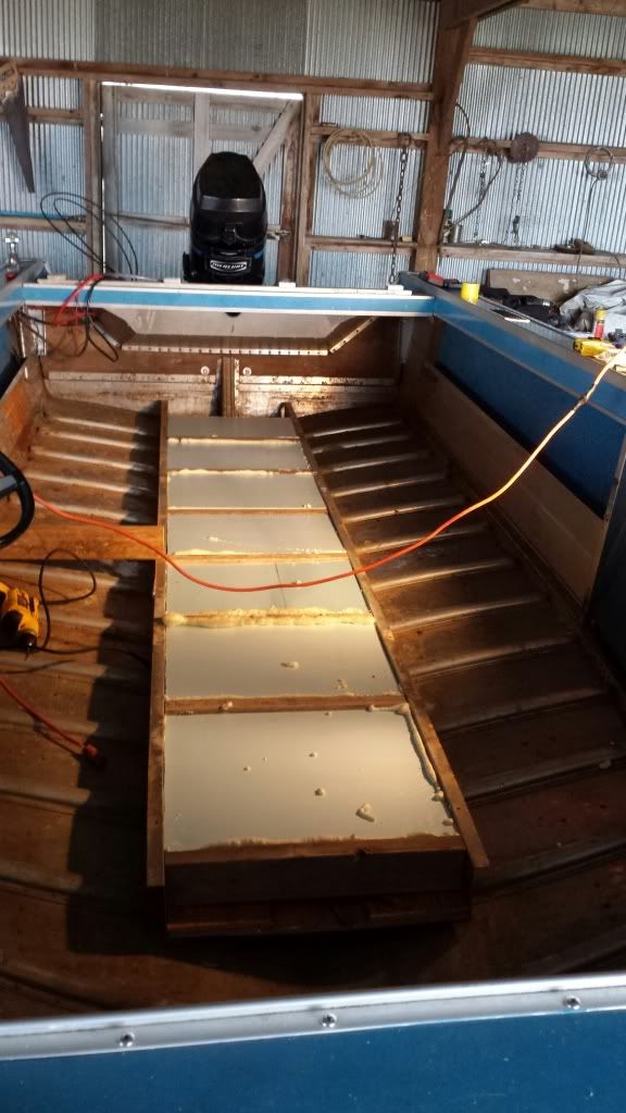

Decided to add some cross bracing between the stringers since we're putting 1/2" wood back down. The ply and 2x4s were free / leftovers so, fit the budget well.
Cut foam to size and sandwiched 3 layers with expanding in between and around the edges. Makes for some pretty solid blocks that you can actually walk on, so more support for the ply. Spaced so that the ply seems will land on center of a cross brace.
Looks good I like the way you locked it all together.
Did you seal the wood?
Doesn't look like it's treated.
That will make for a very solid structure under the deck.

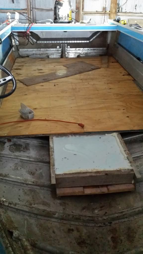

More foam cut to staggered width and glued together lays flat. Nothing sits lower than the ribs so water is free to exit. Although we've never had any come out the drain after use, pretty well leak free.
I agree it doesn't look like any of the wood work has been sealed.
Sheet foam work looks well done, just don't over use the spray foam.
Yeah this is more of a one season fix than long term. Ultimately we want 3/4" flooring with a blue covering. This will be 1/2" and gray carpet just to get us back on the lake. It's 20deg in the barn so we're working quickly, and the boat has a lot more proving it's self to do before we up the investment much further.
I do have some Flood left over that I may apply before I lay the carpet down, has kept my trailer deck in good shape.
CWF-UV | CWF Deck Stain | Flood
Not sure how I'm going to lay the carpet, I don't think the glue will like 20deg temps. But, pushing to get it together so if we catch an above freezing day we can use it rather than work on it.
