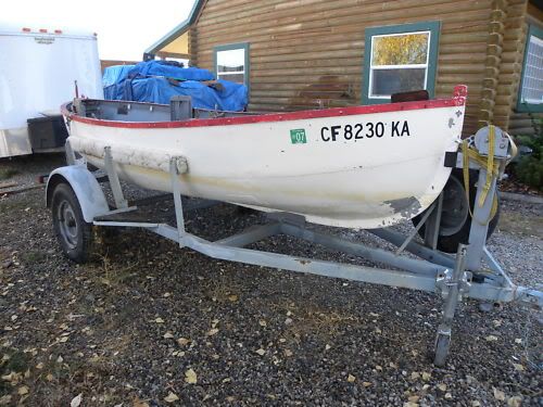

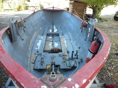

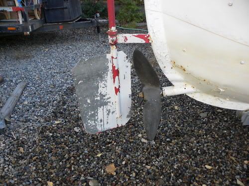

Well, last winter it was the restoration of two nice starcraft boats. I wanted something a little different this year, so I decided to combine my two hobbies (steam engines and boats). Here goes nothing :)
Hull: 1940 Tregoning Boat Co. Steel Rivited Lifeboat (EX US Navy) Needs a little work, ok, a lot of work, but what a unique boat it will make.

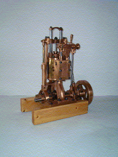

Motor: Home built inverted piston 3" bore by 4" stroke double acting steam engine with stephenson reverse.
Boiler: New 5 hp ASME Code boiler built by Rappahanock Boat Works.
Here are some pics of the hull as I found it:

Is that a little governor thingy sticking out of the top of the engine shaped like a "T"? Missing the flyweights?
VERY interesting. What is the heat source for the boiler? I love this. Steam engines are awesome. I once got to run an early 1900's Monteray hull with a Hicks one lunger gasoline engine, but it ran at about 100 rpm and sounded like a steam engine and it had an open valve train that had to be hand oiled with an oil can. It was so much fun and I can totally see where this would be the killer fun boat to take out on a lake or bay cruise. Outstanding. However, not too much expertise to add from me. I'm going to be a spectator on this one!

SS,
The brass cover at the top of the engine is just the end of the crosshesd guides. This is an inverted cylinder with the piston rod exiting the top of the engine. There is no need for a governor, as the prop creates constant drag and is always "in gear" so there is no chance of overspeeding. I am pretty familiar with steam boilers and am following ASME code on this one to minimize chance of injury. It will be coal or wood fired.

Here is an animation of a similar inverted crosshead engine. It will give you an idea of how it looks while running.
