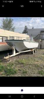

Thanks guys just getting ready to do stringers and new floor. Never dun fiberglass before wish be luck post pics of work when completed. Also i have more info pics and a bit about how this came to be in my other posts

I cannot tell how bad the stringers or floor are from the photos. However, they don't look too rotten as you would see debris falling from them.
The floor looks to be intact, except the white rectangle may be a patch.
You are going to install foam floatation under the floor, right?
The motor in the photo looks to be a Chrysler.

The Chrysler was a lost cause spent 2 months and a few hundred Tring to keep it but no luck. Currently going to run a evinrude 125 i believe a 71 or 72. Stringers are delaminated and a bit rotten in the rear from sitting uncovered for 4 years im assuming, but im replacing them anyway. Transom is solid. The rectangular spot was from the carpet there was a gap in the carpet there and its just discolored but floors getting replaced as well front to back
