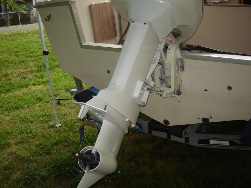

Just a couple before and after pics.I got all the electrical and guages working also.

:cool: Your really gonna enjoy that boat,look's fine so far. I take it you've put on a new lower end? if not what kind of magic was used to get that leg that clean??

nice job, you'd never know that was a blue lower. when are you gonna dunk it?

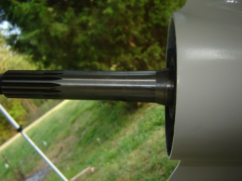

Went and got tags and registration today. Was going to put the prop on but the thrust washer off the old lower is too small.The new lower has a different taper to it..:mad:
after some research on the BRP site i found the part number changed in 1987.So guess the new thrust washer is just a tiny bit larger. Same splines and all but the taper is longer on the new lower..The prop slides right on without the washer.The guy i bought the lower from said he would find me the right one.....So,i guess it will be the end of next week when i get back from Texas before i splash it:rolleyes:

Super job. I know you are tickled about the whole deal. I know you put another lower unit on, regardless, you'd never know it was the same engine.

Thanks Mark,The mid section looked really bad also but after taking the wire brush to it and getting it down to bare metal,then sanding the heck out of it,i used JB weld to fill some small pit holes.Then sanded that all smooth.2 coats of primer then 3 coats of paint. I have some Johnson factory paint ordered to put another coat on then paint the hood and new decals..The paint i used is just a shade lighter but i wanted to go ahead and get a good sealer coat on it.
I'm still trying to get the right thrust washer for the prop.The old one is too small.i think this lower is a 91 or 92 model and the taper on the propshaft is different..I got one coming in the mail but not sure if its the right one or not.I may end up towing it to a dealer to have them find the right one.:rolleyes:

I like your idea about taking it to a dealer if all else fails. The resident mechanic can probably go to the parts bin and have you a washer in a heartbeat just looking at the thing.
