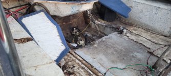

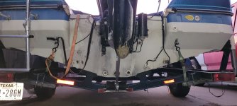

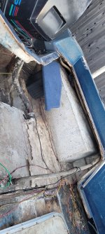

Thank you so much! I really appreciate that info. I'm learning this the hard way but enjoying the process along the way. I will definitely look into this. I do still have the question of what are these boxes and could I do with out them? Also do y'all have any idea of the length of this transom I think it's short but I'm not sure.

Those are flotation boxes. Required to keep the boat from sinking when you leave the plug out

Thank you, wish it wasn't required but better safe than sorry. They are soaked so right now I think I float better than they do lol. Do you happen to know if they are connected to the transom? I fear if they are, the transom will be toast; although, tap test sounds good and it doesn't move more than a 1/4 of an inch when put pressure on the lower unit but it seems there is a small amount of separation up top.
52,798
your boat rotted from the drain up. so the transom went, then the stringers, and then the floor (always last to rot).
tapping does nothing unless the wood was wet, rotted, dried, ants ate whats left of the rotten wood, etc. then you hear the hollow sound.
your transom should never ever ever be able to move.
