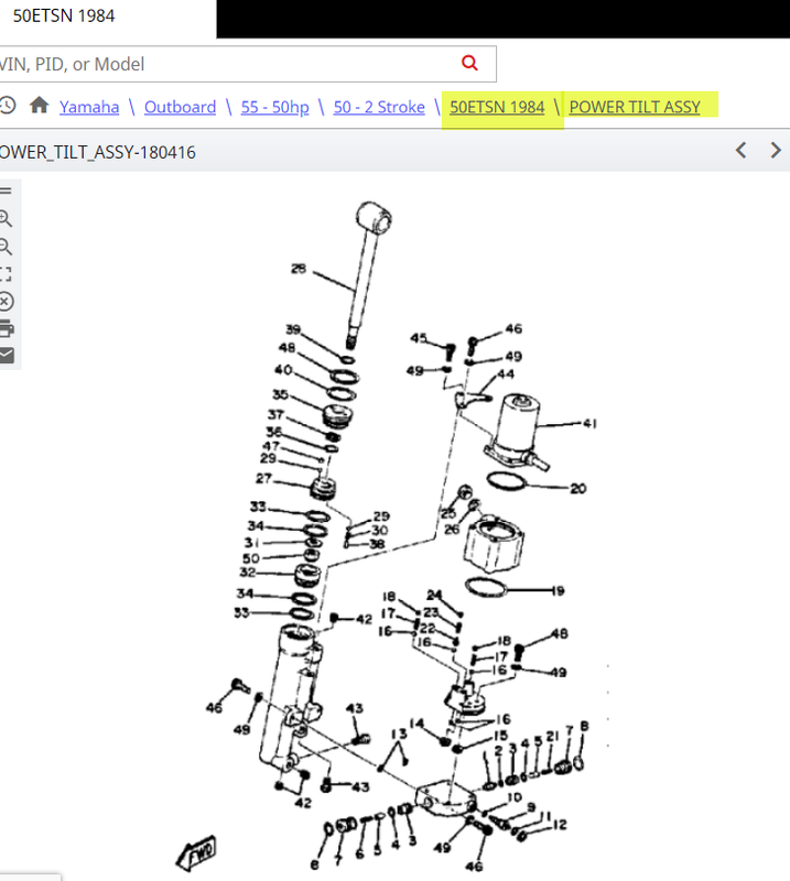

boscoe99
Aug 22, 2013
2,233
The parts catalogs show that the 1984 50 HP models did not come with trim and tilt. Power trim only.
The attach parts for power trim are more than likely different for trim and tilt.
