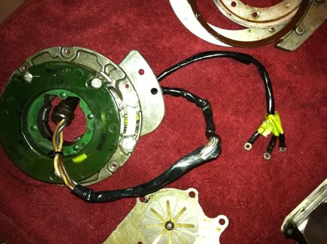

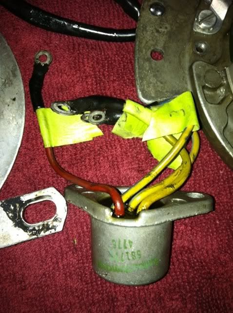

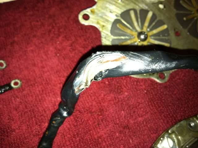

Upon review of the rectifier and stator today, I noticed a wire on each where the sleeve has deteriorated and the wire(s) are showing through. I was just going to replace the parts, but at $330.00 for the two, is there anything wrong with just splicing the wires and repairing them? Pics below. The rectifier is the red wire that's exposed.

Upon review of the rectifier and stator today, I noticed a wire on each where the sleeve has deteriorated and the wire(s) are showing through. I was just going to replace the parts, but at $330.00 for the two, is there anything wrong with just splicing the wires and repairing them? Pics below. The rectifier is the red wire that's exposed...
Yea, pretty spendy. I would repair it, and use some heat shrink tubing or liquid electrical tape.

Sounds like a plan then. I'll fix those up while waiting on my parts.

On the wire repairs: I'd try the repairs, but keep an eye on them; they can corrode from the inside so easily. One of those life-long problems in salt water. Your parts would be about the value of the motor. But I'd get it running first, then keep an eye out for cheaper parts down the line

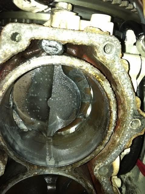

Can someone please verify that the original owner/previous rebuilder installed the pistons in the correct direction? The pic below is how I found it when disassembling:
The motor ran fine before, so I'm assuming he did, but when I look at it, it seems that you'd want the piston with the high side away from the spark plug, to alleviate any chance of contact...
Just wanted to verify prior to assembling it.

In the picture above, the exhaust is on the left side, intake the right.
Thanks!
I say you're good to go. I have the gash mark to prove it, LOL.
Actually, the gash is from the compression tester, my bad.
Still runs like a champ though.
