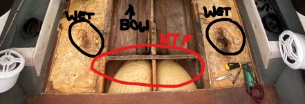

This picture shows the two wet spots I found. They're in the exact same spot on both sides, My guess is this is where the manufacturer poured the foam into the voids, and the seal went bad on the plug they filled in the hole with. Also, the WTF circle is showing partially filled voids at the back of the boat...this can't be good, can it?

Since I have most of the decking out anyway, and I have those two bad spots in my foam and partially filled chambers...and depending on how much it'll end up needing, I might just replace the foam...
So, the floatation foam is just under the floor decking?
Removing the old foam is just good old fashioned elbow grease and a good putty knife, right?

Some have mentioned that a wire wheel on a drill/grinder will go much faster. Have a respirator and safety goggles as the stuff will fly.
JASinIL2006
Feb 10, 2012
5,762
I'd remove the foam from the wet areas and drill-check the stringers on either side. For removing large sections of foam, I found the claw end of a framing hammer worked well, and then a wire cup brush to clean up the leftovers. The nice thing about removing the foam in chunks (as opposed to obliterating it with a wire wheel) is that you can inspect the chunks of foam for moisture as your remove them.
I wouldn't worry about the partially filled voids. Pouring foam is not an exact science and it's probably better to have a few voids than to overfill the cavity and break stuff as the foam expands.
If i find the foam to start being OK, can I stop removing it and just add new to replace what I've removed?
I apologize...I'm sure this has been answered a thousand times in other posts....is there a "best practice" when pouring in the new foam to get the best fill? Do I put the new deck on first and make holes to fill from, or do I foam first, then trim as needed and then new deck?
Also, on the topic of floatation...what about the ski locker? Is anything gained from deleting it and filling it with foam? or would this make the boat float improperly?
If the foam and stringers are OK, you can fill the holes in the stringers with 3m 5200 and replace the foam. For large areas, I think it's preferable to install the deck and cut some holes to pour the foam into. For a smaller area, I'd be inclined to pour the foam before decking it, and if needed, shave off the top of the foam so the deck will sit flat. (If you do the latter, you could even paint the cut foam with latex paint to seal to foam's surface.)
It still is a good idea to core sample other areas, though. In my boat, I'd find pockets of wet foam, then I'd run into dry foam, only to find more wet foam further forward in the boat.
If I was doing it & the deck was off I would pour the foam & once it cured just trim off the excess. It will be messy but the way that stuff expands you're less likely to blow something out. Up to you on the ski locker. I used mine to store fishing gear, etc so I left it the way it was. If you find any wet foam, get rid of it. It will never dry out & adds weight to the boat.
Thanks! That's kind of what I was thinking with the foam too. I was a little worried I'd go through the time and expense of fixing everything just to damage something with the new foam.

For cutting out the foam, I used an electric knife. I did buy a new one for the wife though.... Anyway, easy to slice deep and knock out the cubes. Cleaned it up with a wire wheel and a sanding disk on the angle grinder.
Oh, nice! I like this idea, thanks for sharing! Now, if it would stop raining so I can get to work, that'd be fantastic...I'm trying to get this thing ready before August.
