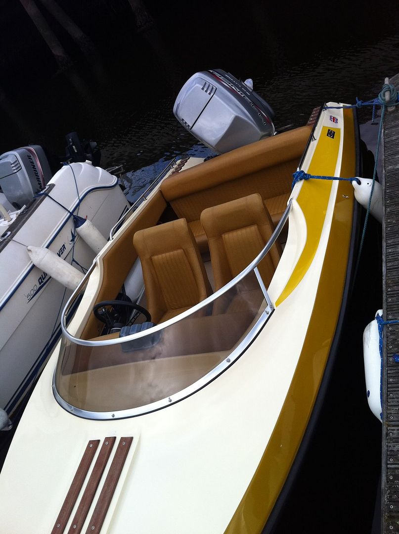

Hi guys, resurrecting this thread as I've finally got the boat out in the water :)
Well the performance is certainly exhilarating to say the least!! I managed to get it off the clock with my current speedo which is max@50mph.
I think it was up to about the 65ish range by how much extra it had after passing the 50 mark. RPM was at 5200ish.
That is far more top end than I'll ever need I tell you. Still didn't manage to get it as quick as it was capable before I needed to slow down for corners in the river.
One concern I've got is idle speed in forwards gear. The boat is doing about 5-6 mph :confused: It's also going up to the top of the temperature gauge. Could this be down to the engine having the wrong prop? I'm going to post a question in the outboards section regarding the temperature, but if you guys can help me I'd really appreciate. Props are a complete dark art to me!
Other than my original description of sizes in the first post, I can't really add anything regarding weights. This is Bumblebee if it helps?

Sure is a nice looking little potato ship.
According to the rpm and a 2.00:1 ratio 23" prop thats 51 at 5200 using 10-% slip.
at 6% is 53.2 You might want to use a gps for speed. And we may need to verify the tach.
Does it end up with about the rear 1/4 of the boat in the water.
did you play with the trim a little?
