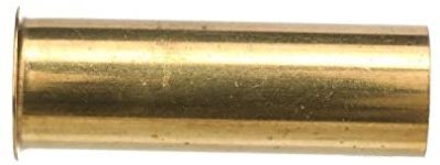

I wanted to mention, but I think I'm too late to not run the bottom of the transome to the hull where the drain hole is. I cut out an opening in the transom wood slightly larger than the opening of what the hole would be and filled it with PB; this way,when drilled I hopefully eliminated a contact point between water and wood therefore eliminating a possible point
I wanted to mention, but I think I'm too late to not run the bottom of the transome to the hull where the drain hole is. I cut out an opening in the transom wood slightly larger than the opening of what the hole would be and filled it with PB; this way,when drilled I hopefully eliminated a contact point between water and wood therefore eliminating a possible point of rot.
my drain hole is 2in above keel I just decided I'm gonna pour resin into a puddle into the keel to set a transducer for depth/fish finder then use 3in copper coated with PB

That's great, but make a hole larger to eliminate the possible wood to eliminate the wood contacting water. I used pex and a little 3m 5200 on the outside, whether I needed to or not.
