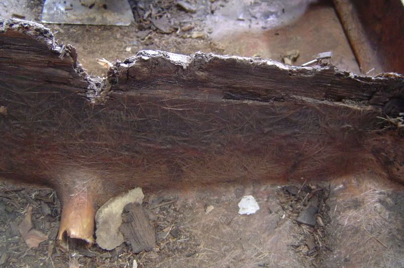

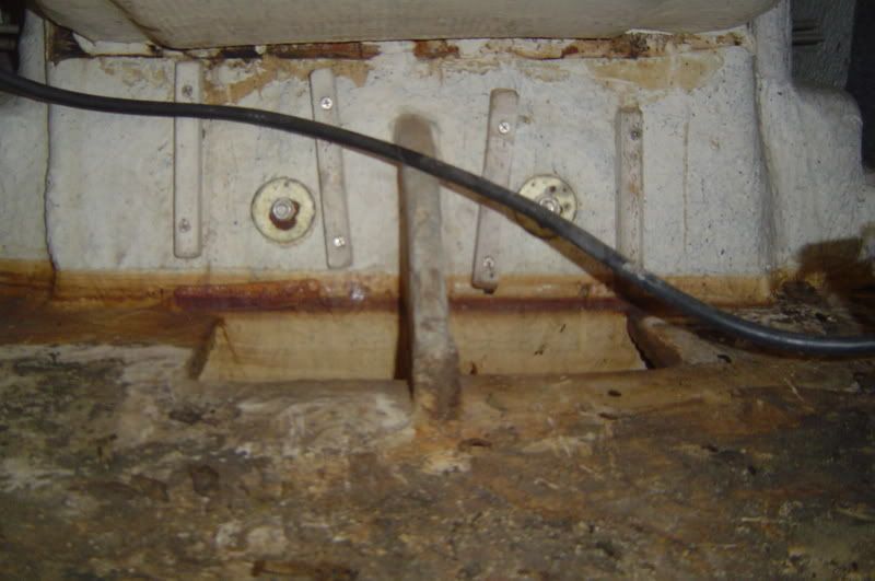

prepare to be unimpressed. I cut more wood further back because I wanted to see if there was any gunk still back there in that tunnel. Some 2x4's from a repair my dad did probably 10+ years ago are still there and sturdy. None of the wood back there feels soft or weak. I think the boat dried out pretty good and I'm not just trying to be optimistic. I realize its not in great condition, I am trying very hard not to be anal about it and make sure its just okay or satisfactory. Forums have a way of distorting whats practical and whats necessary.
So anyway, now that I've said that little tidbit, let me get on to the pictures which I'm going to add captions above or below.

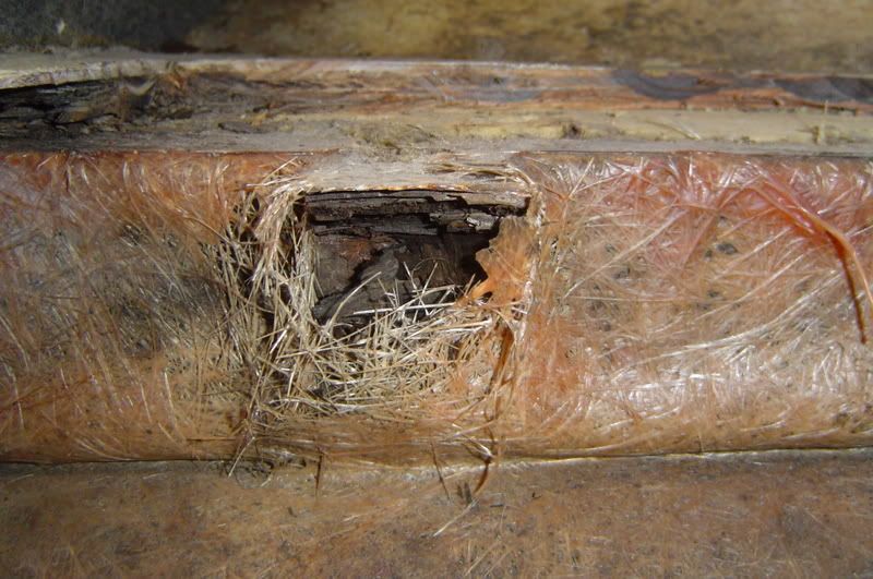

This is the old repair with 2x4's. there were surrounding rotted pieces that fell away but for whatever reason these were pretty unaffected. They dont want to budge so I'm going to leave them.
here is the rotted ..whatever it is. I need the real sangster to come school me again. Seriously.;)
A few feet forward of that rotted cross-sectional piece is where I think one of those are missing. This picture shows some sort of opening coming off the stringers on both sides (opposite each other) that is kind of glassed around and wood is kind of sticking out of. Its rotted though.
The transom area seems to be fine. I tugged on the motor and what not and I didnt see anything moving or separating.
This is the rear of that front tunnel. There is one more compartment below deck under the transom area that I cant really look into. I know that wood is starting to rot.

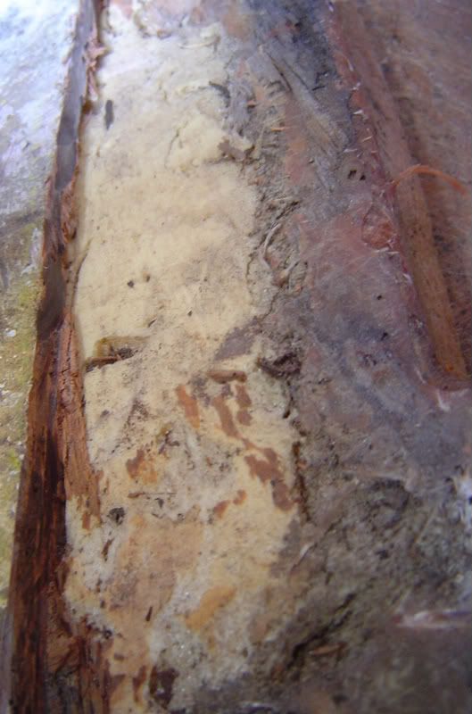

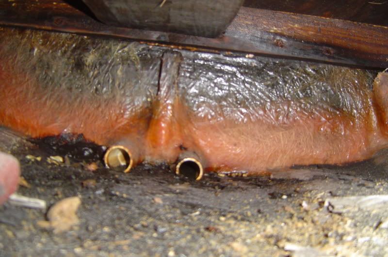

I tried to describe this earlier. When looking from the center of that "tunnel" under the seat boxes I can see foam. A few inches back. I poke it and it feels dry to me. I was going to see if I couldnt clear out all the wood until I got to the foam on both seat boxes and slide the wood in that gap between the stringers and seat boxes.

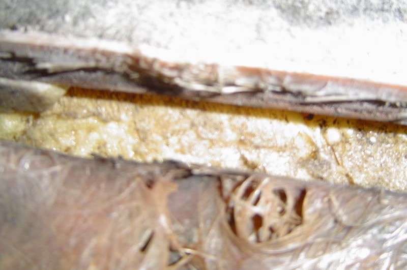

Here's the "foam" on the stringers. Dirty from the rotted wood that sat on top of it before I guess.

The only picture that really scares me at all is the one where there was obvious wood rot from poor fiberglassing. I'm betting that the stringer it comes out of has rot at least a foot in either direction from that point.
Couple of things you can consider doing depending on access. You can make sure that the wood there is dry and use a penetrating epoxy to "firm the wood up" and glass it back in, or you can sister a board across the length of it to bring back some strength and glass that in. It's going to be a weak spot on your boat and if you come down on a wave hard, or retrieve your boat too shallow and the trailer puts too much pressure in that spot, you are going to have some level of failure in the remaining fiberglass.

the foam will be dry when you touch the outside of it.....but its wet inside.....you need to take a core sample of it........

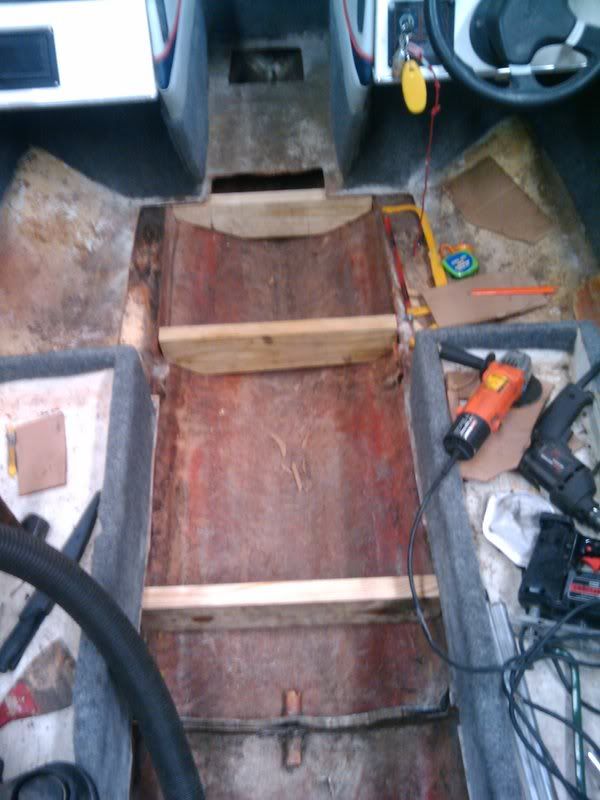

an update
an update

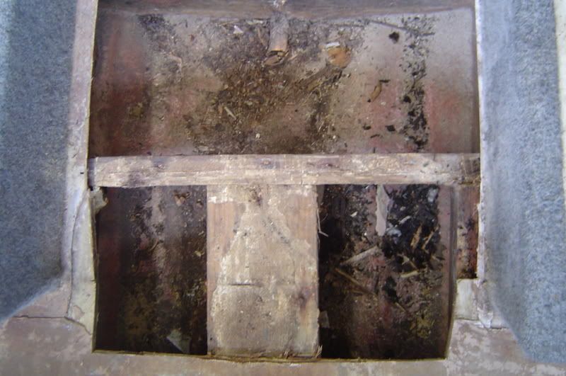

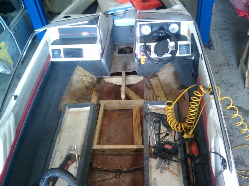

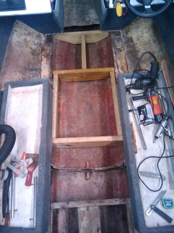

I've followed through with my plans slowly but steadily. I do believe the stringers are rotted after inspecting more thoroughly, but I have to work with what I've got here. I'm sistering boards on the side as you'll see in the pictures and I've got a few cross members as well to brace a bit and support the replacement floor panel. Everything is pretty much cut, all I have left to do is finish applying the urethane paint to the wood and screwing some boards together. I am now starting to look into marine carpet, hopefully I can find something much cheaper than what I've been seeing. I only need to do the rear and middle section. Anyway...on to the pics.
excuse the boards that aren't in place, I was too lazy...but you get the idea.

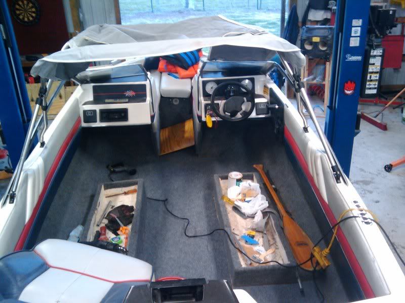

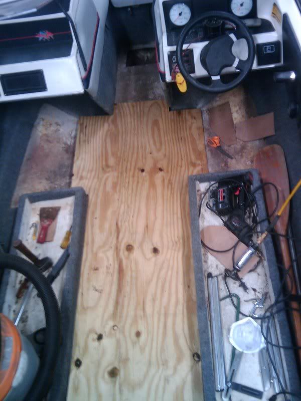

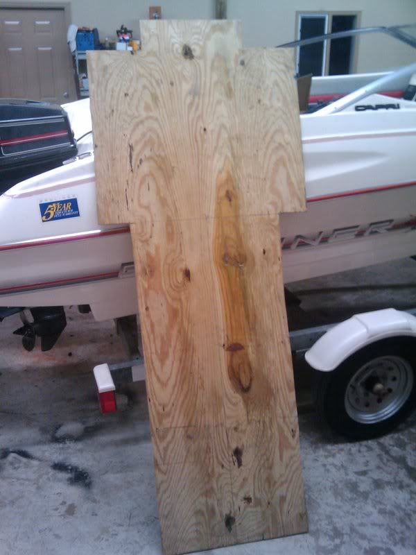

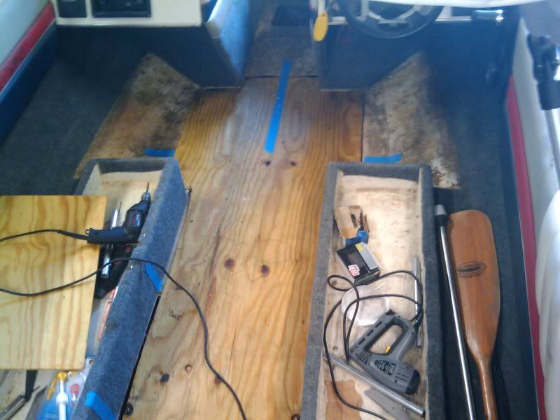

wow my progress has been really slow...almost a full month since I've posted and I'm still not done. I have to really budget for this boat though and I have been working on the motor which is costing me so much more than the deck stuff and was actually worrying me if it will be suitable to even use (possibly making the deck repair pointless).
So I've secured in my little frame and screwed down my replacement panel as well. Now I am working on the home depot outdoor carpet I got. I thought I would be wise and just use a staple gun on it so I didnt have to mess with paste but it looks like I dont have an option in some spots where the staples dont seem to want to hold. I hope to be done tomorrow with most of it and still need to find a way to incorporate a small hatch in the front where there is a hole in the fiber glass. I really want to have at least ONE compartment that I can lock my wallet and phone in and that is where I plan to do it....which means I have to have a waterproof liner for the hatch. Its too bad I couldnt create something cool like a recessed area for a beverage cooler. :cool:
This has already been a lot of work...so much more than I wanted to put into it. I'm ready to be done with it. This thing better frickin' float

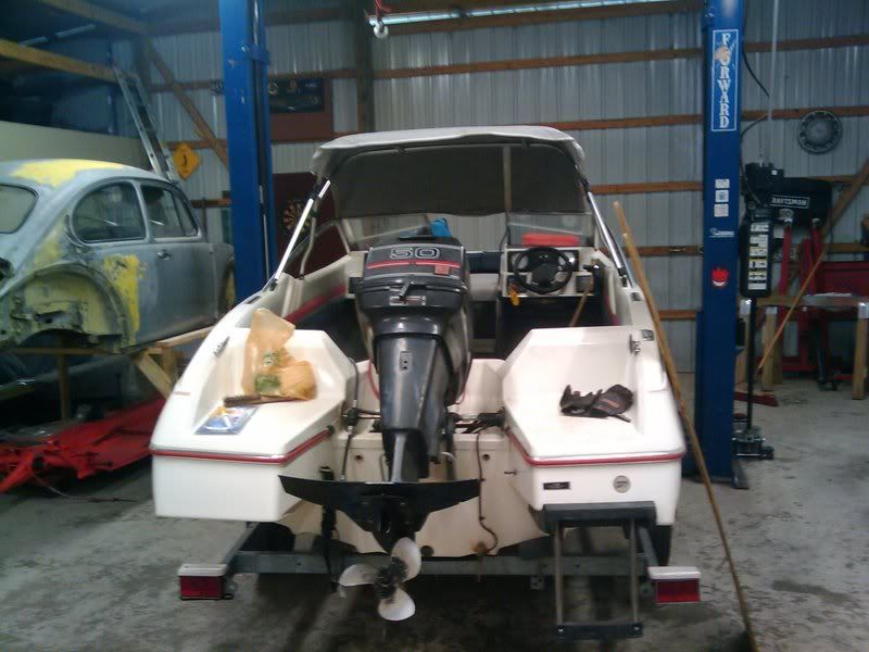

oh yeah and I repaired my bimini top which is pretty sweet.

Im extremely jealous of that shop! I have mine outside under a tree in the front yard :(

Chillin, did you fiberglass where the old deck meets the new? looks like you didn't, which could be a big problem as water will be able to just roll through the crack.

Just so you have no doubts in your mind, and are perfectly clear... the boards that you are adding under the deck add ZERO structural strength to this boat! The rotted stringers, etc. make this boat a lot less stable than it once was, and the only thing your repairs are accomplishing is to make it look better and keep your foot from falling through the deck.
I wish you luck w/ your boat, but w/o further investigating, I would be nervous to take it out on the lake.

no fiberglass, too much trouble. id rather the water "roll through" anyway. if those boards didnt add any structural rigidity then i guess the boat is going to crumble to pieces when it hits the water. this was the best i could do on my limited budget. ill let you guys know if the boat sinks when i take it out. as of now, im not worried about it.

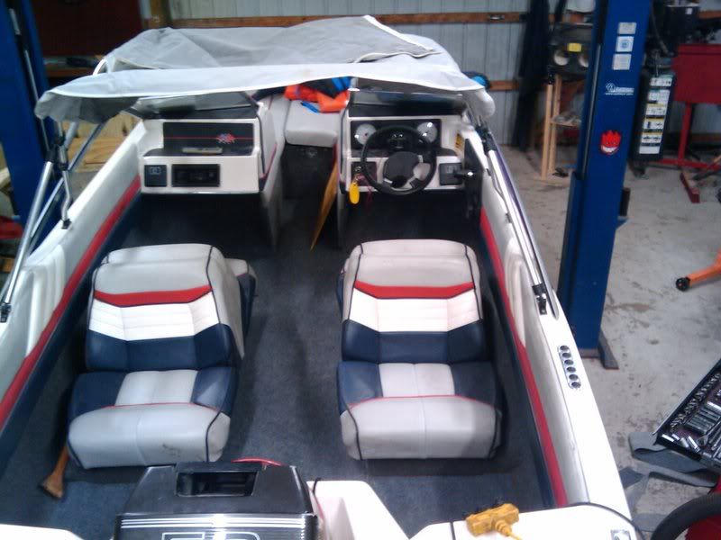

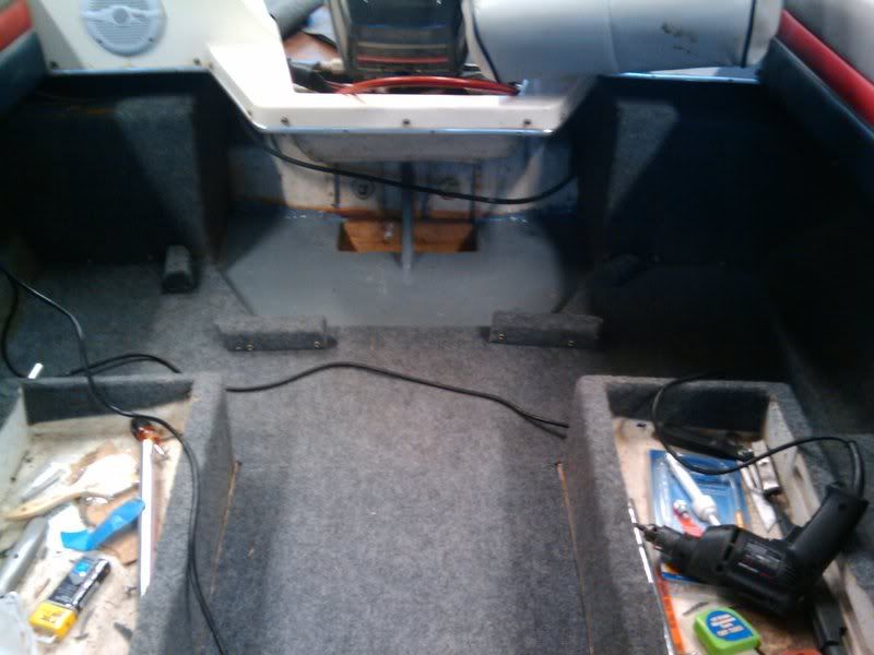

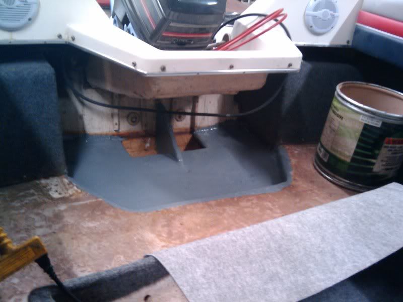

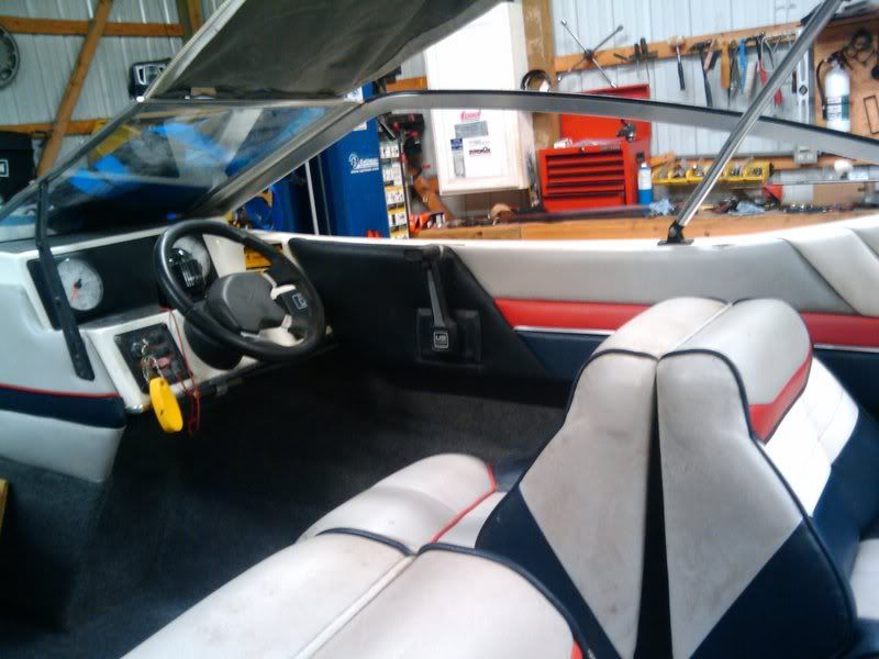

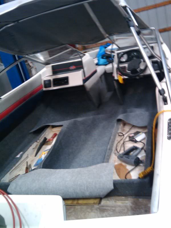

Some of you have managed to instill quite a bit of worry into me as I find myself wanting to throw the boat together already and watch it sink. A repair to the extent most of you deemed necessary simply would not have been a practical decision for someone such as myself who will see a lake maybe a few times a summer. However, I am still curious to hear of instances and scenarios that you believe will come of taking this 30mph MAX 17' foot boat out on a lake. So the boat isn't as strong as it could be...what EXACTLY does that mean to me?

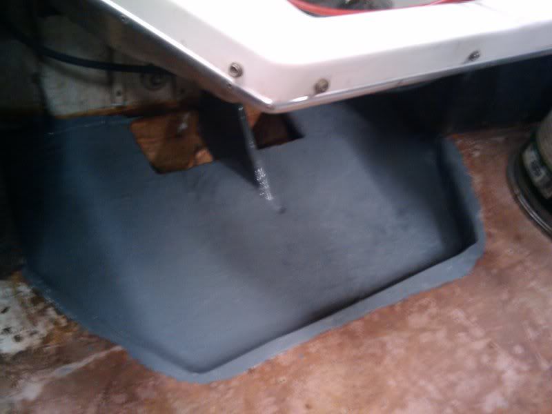

Anyway...I finished the carpet today...not much fun really. Very time consuming. And I installed the seats. I'm not sure why there is a gap on one side of the seats but not the other, I couldnt get them to come together on both sides. (both pairs of seats have this)
