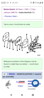

I think sometimes they leak, not stuck closed, but reeds don't fail often on those little motors.
Hand over carb....does it spit gas in your hand? When doing this don't suffocate the motor.
Here's a parts drop.....

behind the carb is a plate behind that plate are reeds ... intake manifold
no fuel sucked in could be CC vacum losssomewhere ( but check the delicate reeds on the failing half of the engine cc.

We pulled the reed plate out and all looked good with nothing, noticeable wrong so we gave it it all a clean and re sealed it. we also took off the water exhaust jacket. You can see carbon on top cylinder and nothing on bottom and the new spark plug is as clean as we put in so we are at a loss as to what else we can do and any other tests if its is crank case compression loss somewhere to one cylinder where it will involve removing the power head and major strip down. What I can say was well when we first started the engine after doing the head gasket, and cleaning exhaust/water jacket and it was running on both cylinders and then after that appearing to be firing on only one, and if we have to do that we might as well home the cylinders and get and put new rings in. Could a leaking crankshaft seal cause this problem only to one cylinder ?
