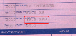

There are many, many, many different F9.9 models. F9.9's. F9.9A's. F9.9B's. F9.9F's
In 2017 there were three F9.9 models offered.
F9.9SMHB, F9.9LMHB and F9.9LEB.
They are not all wired the same. The data plate on the side of the motor provides the complete model and the complete engine ID.
MMM. Motor Models Matter.
Model is 9.9 XPB I'm getting power to the motor and through the fuse, but I don't know how to follow it from there. I had some power at first both to the servo and starter but not enough to engage it. In the end I lost power to everything.
