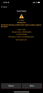

I am getting a couple warnings from my smart craft monitor app. I will post pictures.

I’m getting warnings on my smart craft mobile
“ critical low voltage” and “ecu has detected a problem when trying to output a signal to this device”
