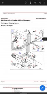

No, that's what it should be doing. Test either how I said or how Rick said. Actually, do mine first to make sure you're getting 12v at the switch.Screenshot_20201114-154505124.jpg

Look at the wiring diagram black is always ground, or the negative side of a 12 v system.
the fuel pump gets the positive 12 v from the purple yellow wire from two different ways
off the starter during cranking
when 12 v positive is supplied to the oil pressure (ignition switch is in run once engine is started) the oil pressure switch closes at 5 psi to make sure the ignition isn’t inadvertently left on or engine dies out... the down stream side of the oil pressure switch is the also a leg of the purple yellow wire as they are spliced together in the harness. If the oil pressure switch doesn’t work fuel pump will run while starter cranks but then stop when keys is switched to run ...
