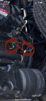

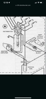

Noticed one of the two wires from shift interrupt switch is sitting disconnected behind the cap..
Also noticed the white/green from distributor rear is spliced into another wire.
