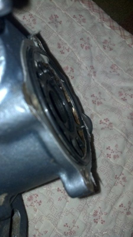

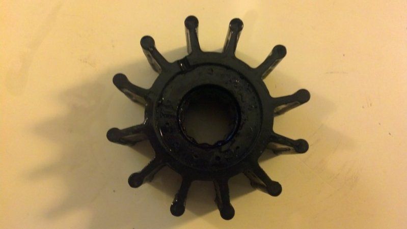

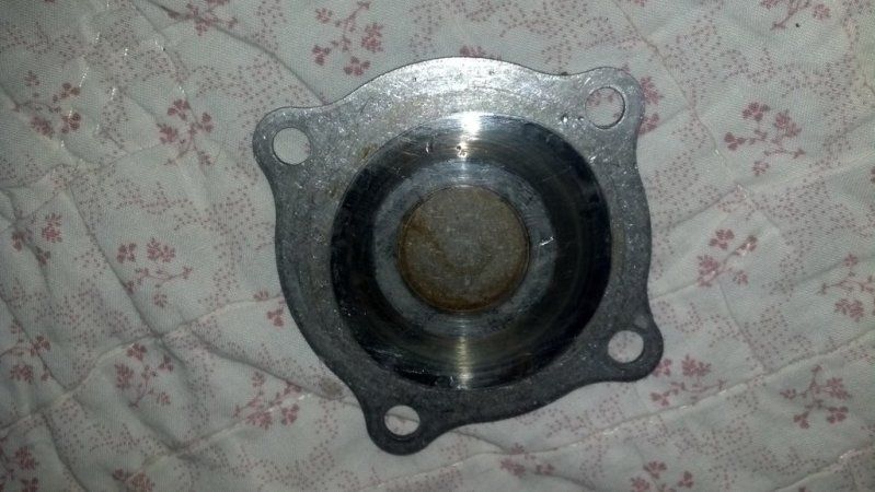

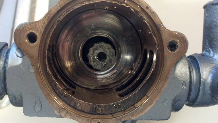

Here are some pictures:
Capt Ken
Jul 30, 2002
2,270
Re: No Water Flow - Yamaha Sterndrive L4
Why is the pump shaft not in the center of the wear plate hole?
55evinrude
Apr 11, 2011
252
like everyone has already stated check all hoses going to the thermostat and circulating pump for any debris. why does the impeller housing look all deformed around the around the edge inside, I doubt that would effect anything but you never know.
