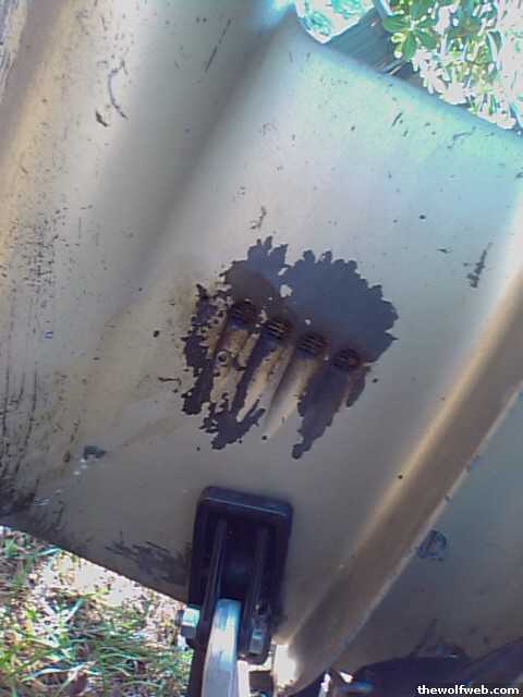

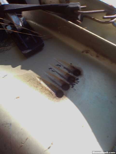

normal? oil leaking out of lower unit vents
qobra
Jul 14, 2008
6
the motor has been tilting up for who knows how long, yesterday i put it down so it sits like it normally would, to work on it.
then i propped it back up.
today i go do the same and i see it has oil around the vent areas and the back.
it looks like its kind of old oil... but still
these were pretty fresh it looks
F_R
Honorary Supreme Mariner
Jul 7, 2006
28,226
Re: normal? oil leaking out of lower unit vents
After sitting forever you are going to put a new water pump in it anyway....aren't you? If there is oil coming out of those round water inlet holes, and I'm not convinced that it is, but if it is, it came from the drive shaft seals under the water pump. Simple solution: While you are putting a new pump in replace the shaft seals while you are there.
qobra
Jul 14, 2008
6
yesir, water pump is def. on the list.
but i really wanna get it started first so i dont buy things for a motor that doesnt run.
F_R
Jul 7, 2006
28,226
A wise idea. The oil leak can wait that long
