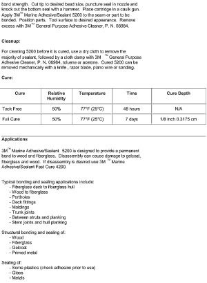

Didn't mean to cause any grief but wanted to relate my own experiences for the benefit of other members. Here is the data sheets from 3M. Read them and draw your own conclusions.<br /><br /> web page

Here is the rest of it.<br /><br /> http://img.photobucket.com/albums/v691/rodder61/3M-2.jpg <br /> http://img.photobucket.com/albums/v691/rodder61/3M-3.jpg <br /> http://img.photobucket.com/albums/v691/rodder61/3m-4.jpg <br /> http://img.photobucket.com/albums/v691/rodder61/3M-5.jpg <br /> http://img.photobucket.com/albums/v691/rodder61/3m-6.jpg <br /><br />If you are feeling unsure about the 5200, why not remove the screws and see for yourself. Thats what I did. If it looks OK, then reapply the 5200 and install the screws again.
