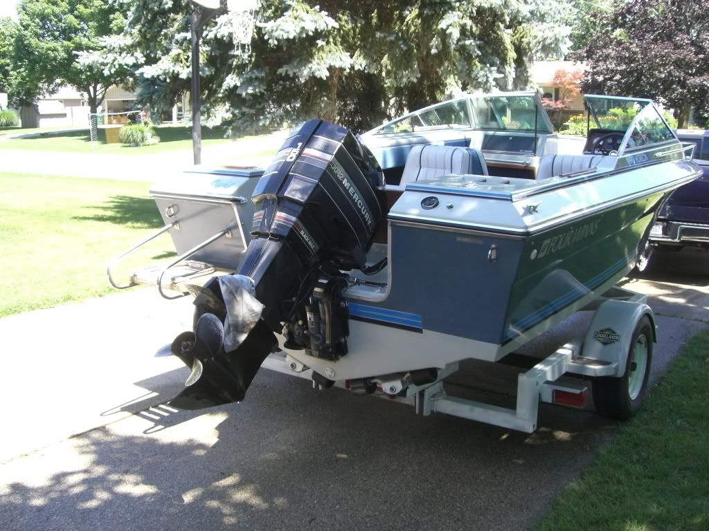

mxzeatr
Jun 2, 2010
188
Re: Oil Alarm Woes......1987 150HP v6 BlackMax
Here's the only pic of my lower that I've got....Likely doesn't help???
I've been trying to look for SS props, but unsure of 2 things.
1) Is it a 'small' case or a 'normal' case
2) Should I stick with the same size 14" 19pitch, or turn something a bit different to get more rpms?

j_martin
Sep 22, 2006
7,474
The prop shop I deal with will let you try a prop for a day, provided you leave credit card info, and don't rototill with it. He's even asked me to test a prop or 2 for him just to let him know what I think.
The smaller LU,s use a prop that has a 4 inch bore, and the standard LU uses a 4 1/2 inch bore. The LUs are bolt interchangable, so even the serial number doesn't really mean much.
A stainless prop is enough thinner than aluminum to grant a considerable performance edge. Also you can usually get away with surfacing them a bit, where a V6 will rip the ears off an aluminum prop driven like that.
My XR4 is hot enough I needed a 24 inch prop to hold it down. There's very few motors that'll pull a 24 inch 4 inch bore prop, so I found one that the prop shop was trying to sell and got it for a hunnert bucks. I surface it a bit, and get decent top end, without sacrificing a neck snapping hole shot.
Faztbullet
Mar 2, 2008
15,938
Only the Xr4 & Xr6's came with the small "inline" lower unit, all the Xr2's was a standard 150 with :200 divider plate,200 tuner and advance box and made about a extra 10hp.. As for your boat it has a non-planing hull so stay with a large diameter prop(13 3/4 or larger) or a 4 blade aluminum...
