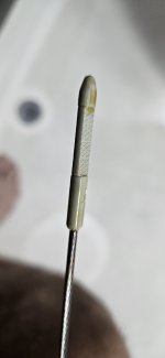

Trying to avoid possibly repeating an overfill that likely fouled my plugs. Online sources indicated capacity is 4qt if you don't change the filter, 4.5qt if you change the filter. It has integrated red cylinder filter housing (paper Mann style filter) so I'm assuming 4.5qt. I pumped the oil out of the threaded dip tube. I then refilled with 4.5qt. Dipstick showed no oil in the checkered space. So I add a 1/4 qt at a time checking the dipstick. No change visible. After another .5qt bringing total added to 5qt, the oil barely touches the low end of the checkered space on the dipstick. I'm assuming at least .4qt remained in the pan with the pump method so after a 5qt fill the total could be 5.4qt which might be in the danger overfill zone. See image of dipstick. I've read that these are unreliable because of variation in the tube bend and lengths which is disconcerting.

Replacing plugs corrected rough idle/vibration situation but now I'm worried about repeating the same mistake as the dip stick seems way off published capacities. AI is claiming these engines all have the same size oil pan and true capacity is 4.5-5qts. Here I sit with 5 added to whatever remained after pump out and you can see the dipstick looks like I'm nearly a qt low?!! Guessing 5.4qts total in the engine right now which might be borderline too high. Last season I filled to nearly the high mark on the dipstick which likely was 3/4qt overfull if 5qt capacity is the real baseline possibly causing plugs to be fouled.
If anyone has experience with this, please let me know. Do I ignore the dipstick altogether? If I filled to dipstick high checkmark, I would have added 5.75qts + residual = 6qts which is way over published capacity. What's a safe amount of oil to add? I did try to level the engine before reading the dipstick but there's not a flat section on it to place a level. It appears that "full" for this is barely touching the check marks? Hate to run it too low but running high is just as bad. I've had cars that varied from published capacities depending on date of production because of multiple pan designs. AI is adamant that this engine capacity is identical in all configurations 4.5qt.

The only thing that might help is to put the measured amount oil in the engine and either let it set an hour or so with the dip stick out or warmup the engine with the dip stick out. The hole on the bottom of the tube fitting is small and with the dip stick in place does not let the oil in the tube find its level.

I have seen similar things with my ancient 1988 OMC 4.3. These had the dipstick tube that goes to the bottom of the oil pan. I found that if you check it after the engine had Sat a while it may read high unless you leave the stick out to let the level in the tube equalize with the level in the oil pan. If you check it after just running the opposite happens, it reads low unless you leave the stick out for a few min so it equalizes.

Thanks for the replies. I had my local marina check service records on the boat for capacities used in previous oil changes.
2017 5 qt,
2019 5 qt
2022 6 qt.
I added 6 qt last year based on dipstick which may have been too much as my plugs were fouled and smelled like oil this season (long beep, limp/guardian mode).
Service manual does not have a capacity table. Owner's manual shows a picture of 5 individual quarts + a filter but no table of capacities with an actual number. Copilot claims 4.5qt LOL. Chatgpt is saying 5-6qt. Only thing I know for certain is that adding 5qt to whatever residual remained after using hand pump still shows nearly 1 qt low on dipstick.

oil level is about 4" below the pan rail. use that as a guide on your dipstick
53,043
you start to get frothing at about 3.75" from the pan rail because the crank throws are now slapping the oil. however as far as oil fowling the plugs, usually that is blow by
