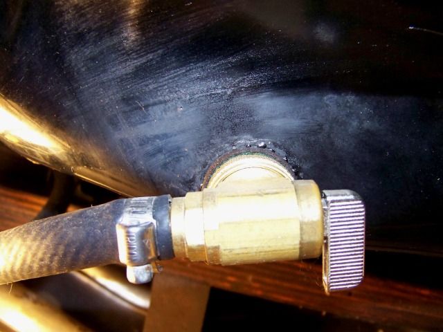

Re: Oil drain hose
Yes, I have this feature. It was well worth the time for me. I wish the filter drained into the pan, too. I can't remember exactly how I managed to match the threads. I used a 90 degree brass ball **** so I could reach the handle and also direct the hose as needed. Give yourself enough length to reach your collection pail. I keep the excess hose trained upward temporarily tie-wrapped to my fuel fill hose so that in the event the valve opens or leaks, I won't lose the engine oil into the bilge. - Grandad
