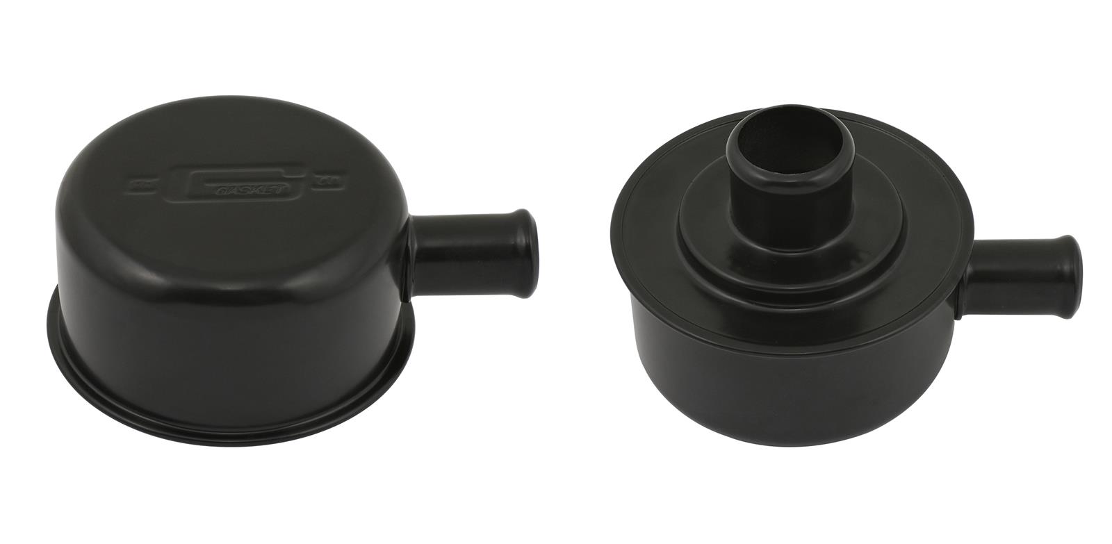

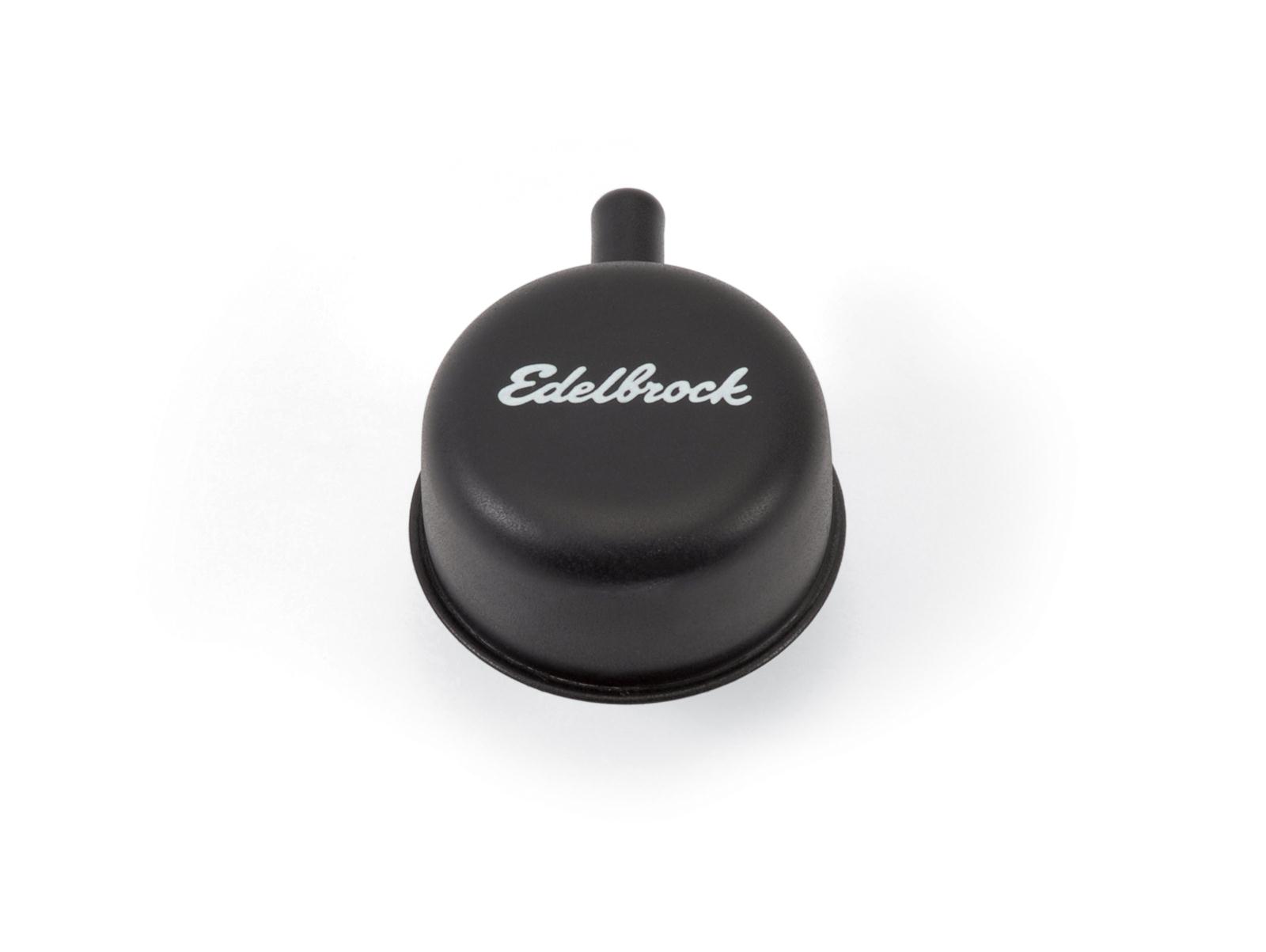

Post a pic
If you have a nipple, run a hose
52,485
Standard breather cap without nipple
Option ,#1, get cap with nipple and plumb to spark arrestor
Option #2, clean the steel wool in the cap every 50 hours. Add extra course steel wool as needed
