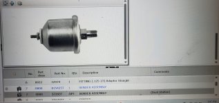

Your motor should have a Light Blue color wire on the oil gauge sender. The oil gauge sender looks like pic below

Now if you bought a single wire switch that is small like the 2 wire one above then that is why the gauge is pegging

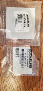

These are the two I bought and are on the motor now. Now that I see it they are OEM and according to the Mercury website they are the correct parts...Unless I made a mistake. I questioned the shape difference of the "can" shape you posted and the merc website parts guy told me they changed shape. Was he wrong which is possible? Vin 0l072052

The 805605A1 is a switch and opens when oil pressure comes up. If connected to a gauge it would peg it and once oil pressure builds it opens and gauge drops to zero
Merc part is 8M0068784 and is expensive
Sierra is 18-5899

The switch you bought would work if attached to alarm circuit

I think I figured this out. In post #10 the diagram shows 18,12, 11,13 as a tee assembly which I replaced the entire assembly. I bought 11 which is the part with the pigtails in my pic. Naturally I bought #13 which is on the tee. As it turns out 13 is the alarm by the distributor and the pic is wrong or I have a different configuration. What I needed was #7 waaaay over there in the diagram and nothing like the setup on my motor
