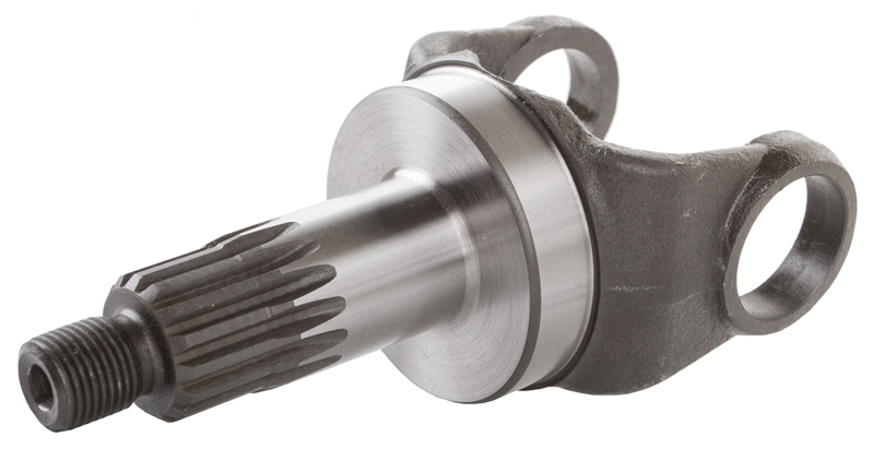

Some have mentioned that a worn yoke can be repaired with a Speedi sleeve. How do I find which sleeve I need? If I replace the yoke, the parts diagrams list GKN and Meritor part numbers. Is there a way to tell which one I need without taking it apart? Would a clamp-style press be sufficient to press out the U-joints, or would I need an H-frame press?
And finally, I can find aftermarket yokes from SEI and others for much less than Merc. Any reason not to use these instead of the more expensive OEM part?
you can use the ball joint press
The yoke is probably ok but I usually use OEM parts.
The speedi sleeve willing to bet if you search here on iboat you will find the size . also you can find info about repositioning the seal about .030" rather or less deep into the housing so it rides on a different portion of the yoke where there is no groove.

the 2 types of yokes can be identified by the color of the yoke black or grey.
#9864281A 2UNIVERSAL JOINT (1 required per assembly) (Black) GKN Assembly
#10853635YOKE, Gear End (1 required per assembly) (Gray) Meritor Assembly
i have used SEi parts for years and i can say their parts hold up as well as OEM

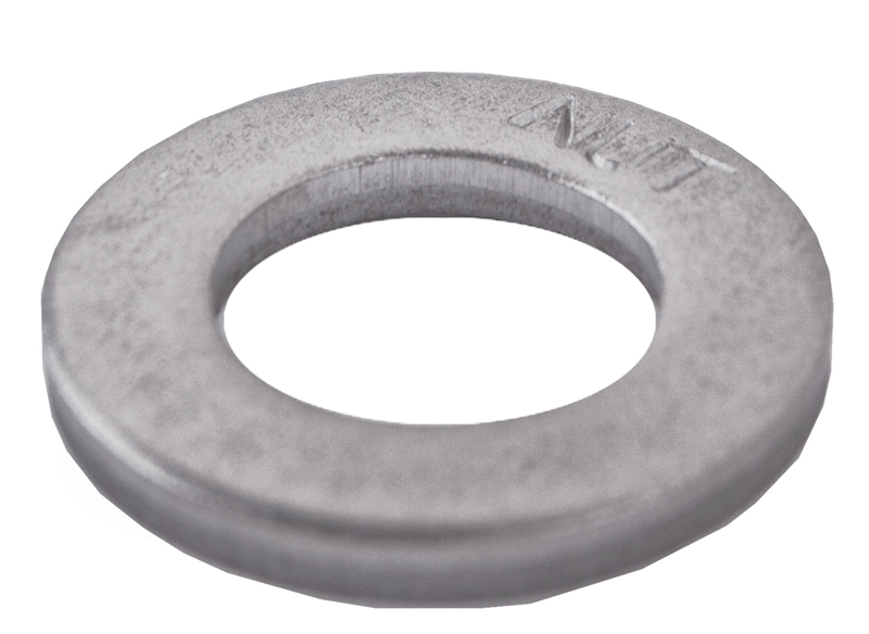

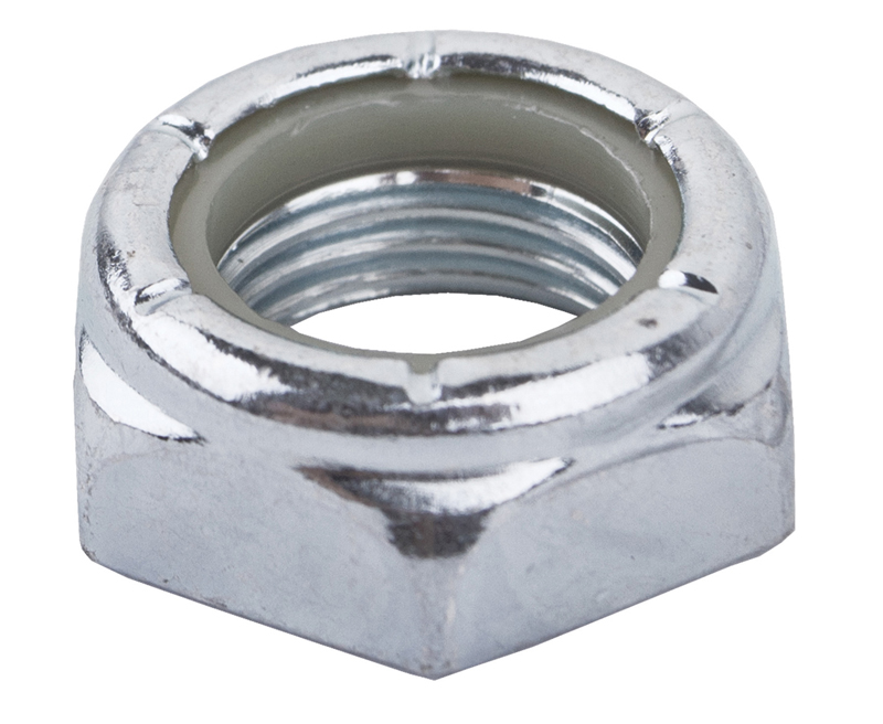

dont forget to get the lock nut and crush washer.
This is helpful, thank you!
