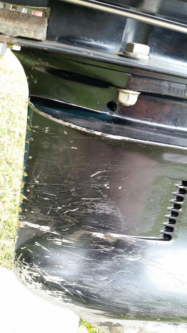

update, the leak had stopped with LU trimmed up, I trim LU down today and right after I had oIL dripping out of the weep hole below nut.If pic came up.I am thinking now I may have a bad drive shafts seal, upper.
philbullet
Aug 14, 2014
241
Wil do?
I guess it woulg be better to just remove outdrive and splite apart and then preasure check?

If you drain and pressure test you might find where it's leaking with soapy water. Once you split you still will need to find the leak when it goes back together
ktbarrentine
Lieutenant
Dec 12, 2011
1,296
Wil do?
You cant test the halves of a gen II after it is split (like you can do with a pre-gen-II, by just plugging the oil passage mating holes). Has to be tested as a unit. You can still soap-bubble check the usual suspects that way..
