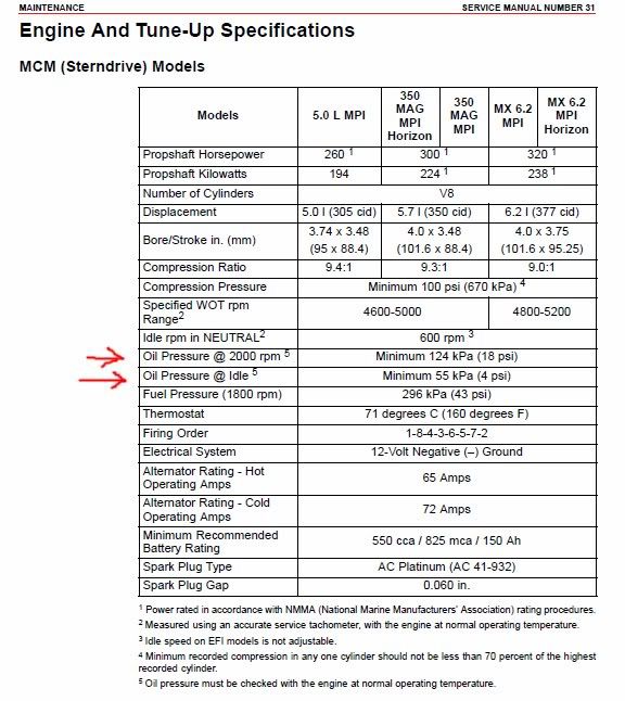

2001 and up Mercruiser 5.0L, 5.7L, & 6.2L oil pressure specs:

What should it be on a mercruiser 5.7, at idle & on the gas?
For comparison/using stock dash gauge:
My 2003/150 hr 5.7 with either 20W-50 or a straight 30 weight at op temp:
@ idle/~550 rpm: 20-25 psi.
@ WOT: 65-70 psi

Thanks for all the replies, looks like the oil presure is ok. My last boat had a big block & the oil presure stayed at 40psi all the time.
