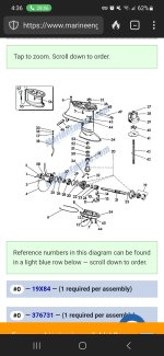

Do I have this right the numbers that collaborate with the link Jimbo sent me? I have a picture of the schematics at the top of the page I'm including for reference. I'm sorry I have so many questions it's my first outboard rebuild and I'm trying to do it right. You guys have been so much help! Some of the numbers don't correspond with the diagram though so I'm going to try and post the link he sent if I can figure out how.

This for a 57 35hp. unfortunately the Site doesn't provide for 1956 models
I'm quite certain that the Gearcase and internals stayed the same between the 1956 thru 1965 model yrs for the Big Twin engine.
This is the link he sent me
