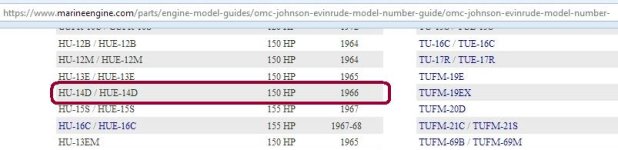

What is this motor ? OMC AU 14D ... if I read the tag right.
Its a V6, what HP would it be ?
Just curious, if this becomes a project, the new transom would likely be for an outboard. What would the OB MAX HP rating be for such a craft ?

that Obsolete Motor Co (OMC) V6 is obsolete. parts are NLA for that motor, and probably the drive.
