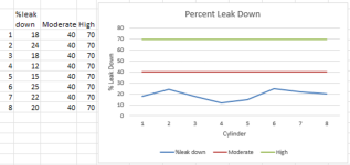

Thanks, Lou, for the quick response. I sprayed some starter fluid around the intake gasket while the engine was idling but saw no change in idle speed like you might expect if it sucked in some air but maybe there is a better way to check that. To check the intake valve, I bought a leak down tester. I applied 100 psi to each cylinder and had leakage between 15% and 25%. That seemed high to me but the gauge suggested below 40% is "green". Hopefully I did the test right. For a moment, I thought I had found the issue because the numbers would sometimes suddenly increase but then I realized the applied 100 psi sometimes rotated the engine so the valve then opened. 1790268180800.png

What do the center electrodes insulators look like on the spark plugs, black?= rich, white?= lean, tan/grey?= about right. Quadrajet carb….are the idle air tubes clean? Float height? Excessive primary throttle shaft play? That can def cause a vacuum leak. You can check it with the throttle cable disconnected with a dial indicator. Up to about .010” is ok, if it’s as much as .020” the primary shaft needs to be re bushed.
