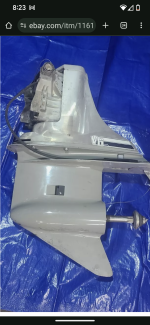

Where could I find this OMC 260 Stringer Manual online? Any idea anyone? Would be appreciated thanks. Also looking ID exactly what I have here. Boat is in operable and unable to power up currently. Is this electric shift? Any assistance is appreciated. Thanks.

OMC 350 Engine MODEL #260SPHRCIF Serial #J724676 - Guessing year 1977 to 1980.
OMC Sterndrive MODEL 882462 Serial # W249091 - 1.41:1 ratio - Guessing year 1977 to 1980

Nope-----It is NOT a hydro-electric shift unit !
Agree to disagree on that. Mechanical units were 1981-1985, silver in color and had a different pickup. Hydro-mechanical shifts were 1978-1980, white in color, and have the pickup as shown in the pics
Below is the mechanical shift
39,756
The last year for electric shift OMC sterndrive was 1977.-----The Hydro-Electric system ( per post #4 ) was never used on OMC sterndrives !!
