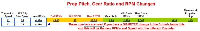

Fab, if you are turning 4,800 RPM on a 17" prop with a 1.83:1 gear ratio the maximum theoretical speed with 10% prop slip is 38 MPH. I ran my prop picker and it says you should be using a 19" pitch prop. I then took this 4,800 RPM with a 17" prop and changed it to a 19" prop and I show a drop in RPM of 400 to 4,400 RPM. Here are the numbers.

hwsiii
