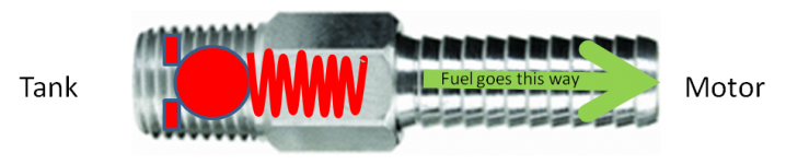

Yep could be that, but also on our own Four Winns, we had a rusty anti siphon valve, that did the same thing, it would start and rev in neutral just fine but would not plane out the boat. Our mechanic replaced it back in 2004 and its been fine ever since. Spring loaded valve that shuts off fuel flow if a fuel line ruptures. Its the barbed fitting that the fuel line to the tank attaches to at the tank. anti siphon valve.png

Yep could be that, but also on our own Four Winns, we had a rusty anti siphon valve, that did the same thing, it would start and rev in neutral just fine but would not plane out the boat. Our mechanic replaced it back in 2004 and its been fine ever since. Spring loaded valve that shuts off fuel flow if a fuel line ruptures. Its the barbed fitting that the fuel line to the tank attaches to at the tank. View attachment 341462
