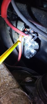

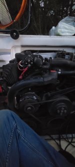

Starter was locked up on boat, when I changed starter, I changed solenoid also. Prior to, the ignition would turn the solenoid. Now I'm getting nothing after the swap. What is a culprit to this?

You may have reversed the 2 primary wires on the main solenoid.
Is there power to the instrument panel?
Lou C
Nov 10, 2002
14,537
Agreed are you sure you wired it correctly? The yellow/red wire from the ignition switch is on the inboard small terminal…
Car1is
Jun 14, 2022
19
What do you mean by inboard small? The right side of ignition solenoid?
