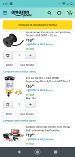

Thanks I like the idea of polishing the fuel, I'm thinking I can park my truck next to the boat, run a line from the tank, through a water sperating filter and into my truck. Any recommendations on what to use to pump the fuel? I got almost a full tank, probably like 15 gallons unfortunately. I was going to get a primer bulb inline like you see on outboards, hopefully I don't need to pump it the entire time? Just a couple pumps to start the flow?

So this is what I decided to get. Gonna try polishing the fuel and burning it in my truck. Next will be figuring out how the hell do much water got into the tank
You may get lucky, but I doubt you’ll get enough head pressure to siphon through a filter.
All you need is a small, 12 volt universal fuel pump. Amazon has a number of them under $15

I wouldn't put it in my truck. Most town recycling centers will get rid of it for you. I bought a battery powered pump from Harbor you know where to drain my boat tank but I only got one use out of it before it quit. Lol.
