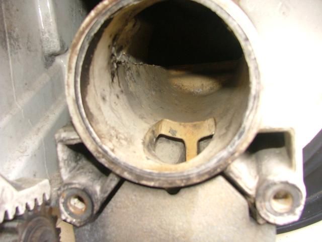

I will have to look at that, because it is extremely hard to start with the drive in the water. I was assuming it was a carburetor issue originally, but after rebuilding and tuning it, I can't believe that's the problem now. I will check the anode grate for blockage. So, if the drive is raised up, I should see this in the back end hole of the intermediate housing, correct?
Looking back into the intermediate exhaust port, this is what you will see. The opening at the bottom of the port is more than enough to let exhaust escape without having to force it down two more feet to get it out the prop hub. The anode block is bolted on below that and I doubt there is any blockage in it.
gottaboatnow
Aug 26, 2010
13
Thanks for posting the pic and I did manage to figure it out. I have two problems, one is electrical, the other is fuel related. I'll get into both issues in the coming days. The boat will start with the drive in any position at all when POWER is applied to the distributor (faulty relay or failed wire to the coil side of that relay). A jumper worked to get the boat back to the dock. As for the fuel system, she starts great, idling well for the most part, and will go into gear and drive as long as you don't ask for too much throttle. Since I've never had the tank out, I'm sure there's probably some gunk in there, plugging up the pickup. I don't think it's ever been out of the boat since 1984. The hoses are so old I couldn't get them off a year ago. I should have done this back then, I suppose. I was smart enough to have the carb open then, cleaned and inspected, and all seemed well once I got the garbage out of it. I'll open it up again once I see the condition of the fuel tank. Thank you both for your help and ideas!
