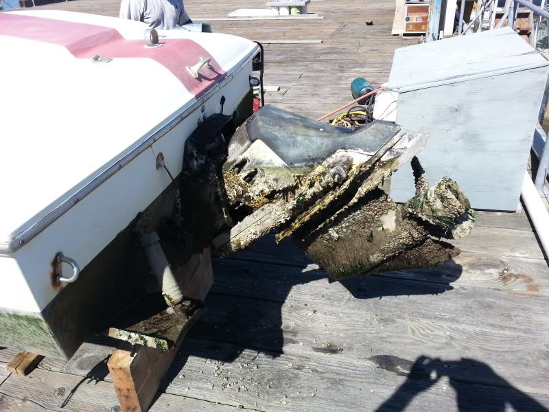

I cannot for the life of me remove the omc drive, this boat has spent nearly all its life in saltwater.
Fire hose with PB Blaster? I'm sorry I dont have any useful ideas.:sorry: How about some pictures of where you are having issues?
Not uncommon for saltwater boats that never get the drive pulled for maintenance. Corrosion builds up around the 6 studs holding the drive to the pivot housing. I wouldn't spend a lot of time worrying about it either. Take the trim hoses off the cylinders or cut them off, they are probably corroded into the cylinders as well. Then remove the 2 pivot bolts holding the pivot housing to the gimbal ring, cut the bellows, hose, and shift cable, and it's off.
Now you have something to take apart at a later date.
Hi Don,
I got the trim cylinders off, and the 6 studs cut, Ive got the shift cable cut, Am levering on the thing hard and it comes out like 1.5" inches but then sucks back in.
Where are the two pivot bolts? The thing is so crusty its hard to make out whats what!
Then you don't need the pivot bolts removed, your problem is the shaft is frozen inside the coupler. The coupler is rubber and you are just stretching the rubber, and that is what's pulling it back in. Removing the pivot bolts isn't going to cure the problem.
I've had to cut the shaft where it goes into the couple to get them out.

That explains it!
I am thinking of taking the torch to it. I can squeeze a sawzall blade thru the cut bellows buts its tight and at a poor angle..

Cut the shaft inside the boat, between the coupler and the transom shield.

I hate when that happens!
That is clearly NOT a Dog-clutch Cobra! (I don't think anyone said it was....)
When you get it all out, check the transom, stringers and floor of the bilge very closely for rot and water intrusion.

I seriously cannot see the shaft inside the boat..
Ayuh,... Put the trim rams back on,...
With the drive Down, 'n usin' wood blockin',...
Block the top of the drive to the top of the transom housin'...
Then hit the trim switch, 'n see if the rams will slide it out, as far as you've been pryin' it out...
Leave it loaded up with the pressure...
If it Does,....
Spray a can of good penertratin' oil, All over inside the transom, Hopefully, ya might actually get some into/ at the coupler...
Ya might also try Wackin' the drive forward, while the rams are holdin' it out,...
a block of softwood, 'n a BFHammer would be the tools of choice...
Can ya pull some of the hull/ boat outa the way to get at the shaft, at the back of the motor,..??
