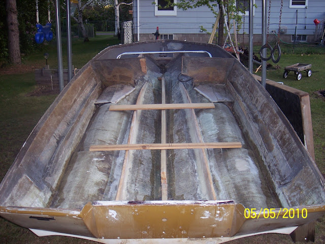

Took the boat off the trailer as I'm apparently off on my stringer heights...a board laid across them has an irregularity up the length of the hull.
You can't really see it in this picture, but the right side of the bottom board is up off the curve of the hull, the other side sits on it. I'd prefer that they both sit right on the hulls curve as I planned to bond the floor with PL along that length to help stiffen everything up and prevent any rubbing from hull flex. I'm not entirely sure what I'm going to do yet. I don't have a sawzall to cut a scribed line with and I don't have a belt sander that I could grind it down with either. Regardless, I've got to come up with a solution before I commit to cutting my deck panels.
I'm going to make sure my bunks are even in heights and then return the boat back to the trailer before I do anything else for now...not that I can do much else with our weather at the moment. As I type this, we have a fresh layer of snow on the ground! Normally, we don't get snow in May...hows that global warming doing for the rest of ya?
