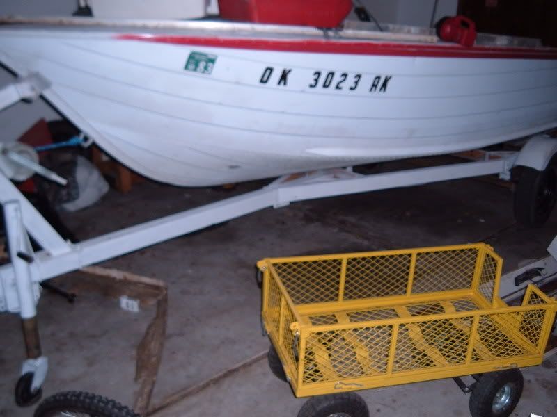

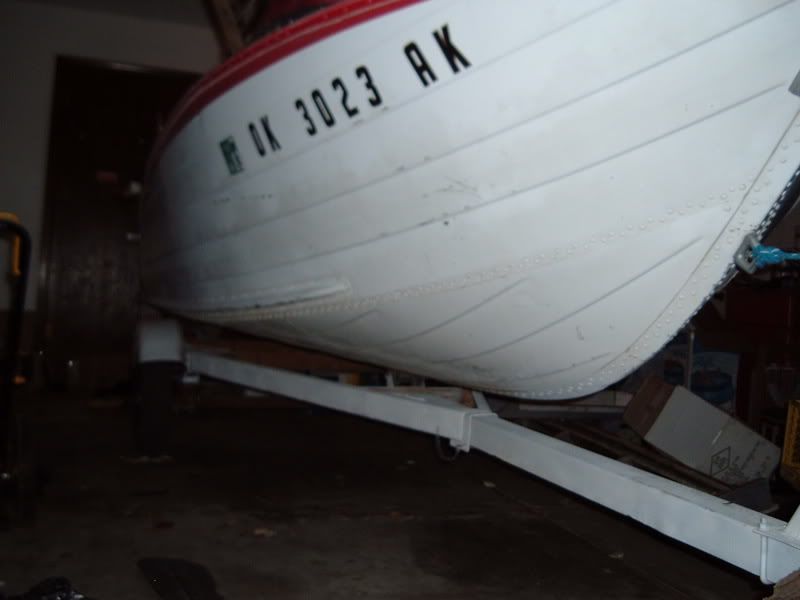

The first two are of the hull of the boat from the outside.
http://i93.photobucket.com/albums/l50/rs051802/eth016.jpg
http://i93.photobucket.com/albums/l50/rs051802/eth015.jpg

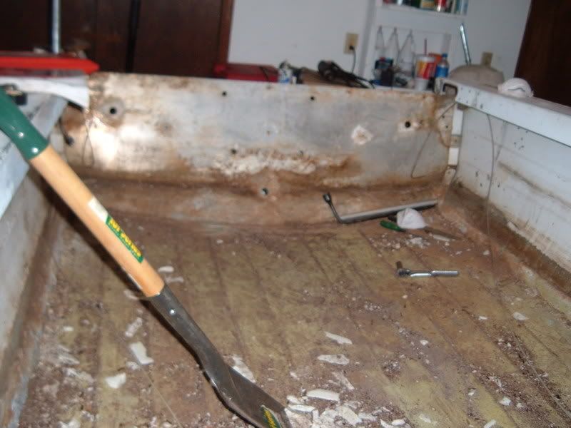

This is a picture of the transom. I think the boat took on water back here, and as a result, shorted the battery which in turn fried all the electrical on the boat and caused some of the reaction to the aluminum as you can see in the pictures.
http://i93.photobucket.com/albums/l50/rs051802/eth009.jpg

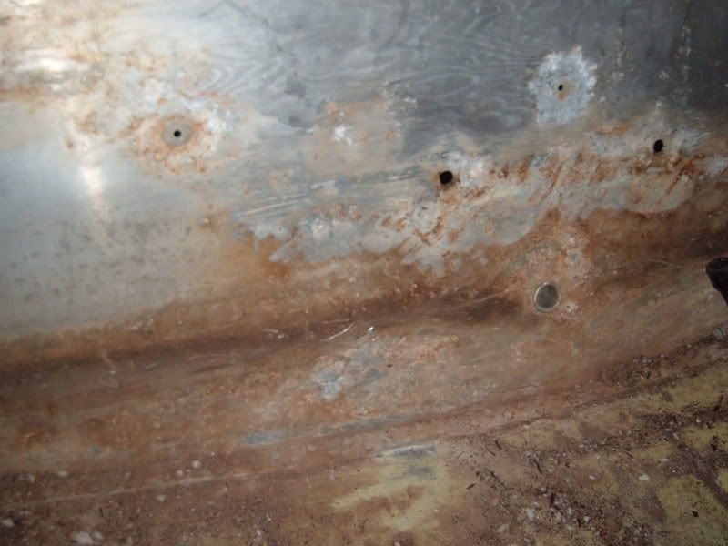

Finally, this is a picture of the hull, bare from the inside. As you can see, no stringers, no drainage. The more I considered the notion of "Foam-Pac" technology the more I wonder if removing the foam was a mistake. The foam was seriously thick, and attached to the hull, and while I don't think I have yet compromised the hull by removing it, I am worried that I will not be able to duplicate the necessary strength the foam adds. Does anyone have any thoughts on putting the foam back in. Should I put it in while it is still a little cool outside to reduce the expansion, therefore allowing me to put more in. It would seem the foam would be denser this way.
http://i93.photobucket.com/albums/l50/rs051802/eth014.jpg
