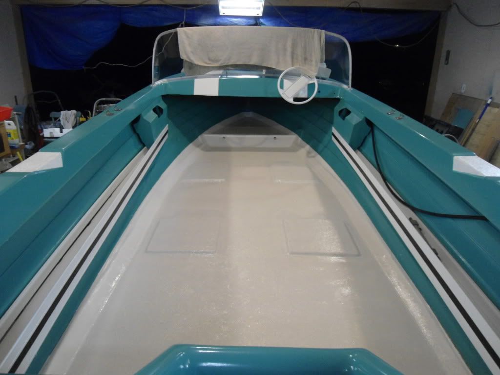

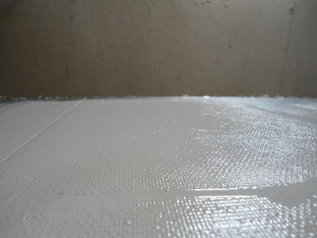

sphelps
Nov 16, 2011
11,508
I played around with some gell and some porch screen .. I f you time it when it just starts to kick and pull the screen off you can get a bit of a texture ..
This was just gell rolled on . Not as shiny when dry and you must seal the gell or it does like to stain ..

Another member Decker used this to seal his new gell . Shurhold Pro Polish ..
I made a mistake and left my boat under an oak tree over night and the oak leaves really did a number on the unsealed deck ..
