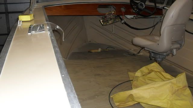

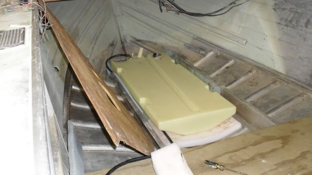

I installed an 18 gal tank in my 18.5 starcraft below deck. Off the shelf from Moeller. #FT1826. 21"X5.38". Fits perfect up forward, shifts the weight perfect. It is poly of some kind. Light weight filler and vent up front. If you want pics mail me at EDIT.

Grzzz, post some pics of your tank and how/where you installed it. Lots of us need more information.:D

If GRZZZZ replies to my email with the pics, I will post them on here. This is the info he has sent me so far.
"I bought the tank from iboats. I found it to be the cheapest. Moeller does not sell direct, only through distributors. The mod # FT1826. It fits nicely forward. The filler and vent are in the front of the tank. outlets come out just under the bow. I ran the filler up front and it comes out a bit in front of the windshield, right side. Vent I put just below it about 6" on the side under the deck. It takes about a month to get one. They are not on the shelf, so plan ahead. If i remember it was somewhere around $275. But well worth it. It gave me lots more space above deck. Come with sending unit installed. My pics are at home. I'll see what I can find and send them."

Here are the pics he sent me.
