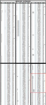

1980 (to be verified) Mercury Black max 150hp. (S/N 5503928). Now I believe it is a 1980 but not entirely sure.

1. Based on the Serial number does anyone know the exact year and spec? See attached spec sheet
