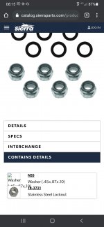

I searched high and low and cannot seem to find a brass 7/16-20 locknut. Both from the local hardware store, that usually has everything you could imagine, and searching the internets. Local store has chrome and ss available. Fresh water, but I'd still be concerned with chrome rusting. Should I go with one of those, or keep the brass ones with the wore out nylon?
Pruno
Seaman
Oct 9, 2019
62
It appears the nuts in that kit are SS. Screenshot_20210814-081509_Chrome.jpg
The nuts in the quicksilver kit are also listed as SS. Maybe one, or both kits are miss labeled?
After learning about galling my first choice would be to source brass. If I'm stuck using SS, is there anything better to lube the threads? I have marine grease, 2-4-C, aviation sealer all on hand, plus all types of oil, something else...?
